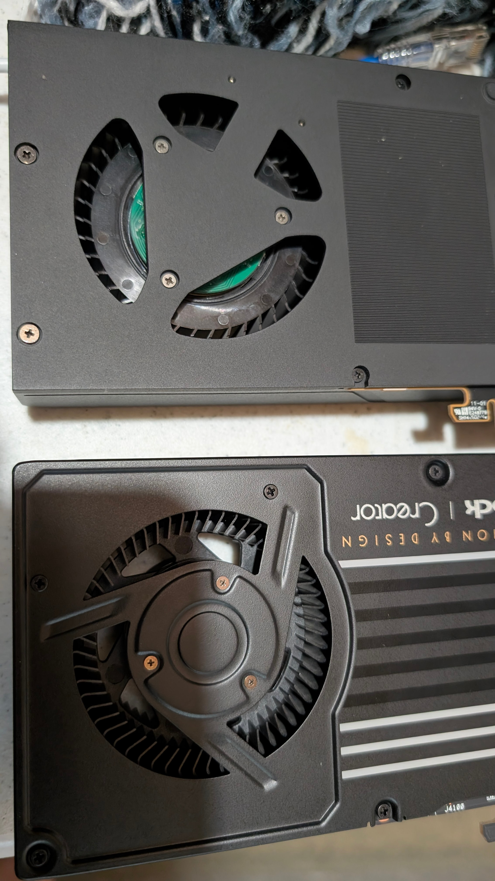

Hopefully this helps some folks. I have both the Asus and the Asrock R9700’s. Here is a full load output comparing the two cards. Load was done via hashcat. Asrock card moves significantly more air than the Asus card while keeping a lower RPM. I have not done DB comparisons of these two cards yet but would expect the Asus card to actually be louder. I did have the gigabyte card briefly and felt that card was louder than the Asus card running hashcat. By the looks of the Gigabyte card you would think the back side is used to pull air into the card but its actually closed off like the casting was done before they realized how the fan was going to fit into it. One other thing to note is the ASUS card does not actually recess the fan the same way the Asrock card does and may choke for air if it doesn’t have a slot gap between the cards.

ASROCK R9700
Time Junc PWM RPM
15s 88°C 122 2354
30s 91°C 170 3321
60s 93°C 181 3533
120s 94°C 188 3688
180s 94°C 191 3725
270s 94°C 191 3725
ASUS R9700
Time Junc PWM RPM
15s 84°C 107 2769
30s 90°C 127 3177
60s 97°C 145 3508
120s 102°C 165 3838
180s 102°C 173 3962
270s 103°C 175 3967

Asus card (top image) has open back intake but the actual squirrel fan intake is on the inside of the blades and Asus only exposes the inside to the front part of the fan. The ASRock on the other hand has the entire inside of the fan exposed to pull air from the back. When I covered the back of the Asus card with tape and ran tests the temps were exactly the same. I’m not sure it even pulls a vacuum from the back with the way it’s designed. When I first compared the cards, it was such a large difference in airflow that I thought the card was broken.
