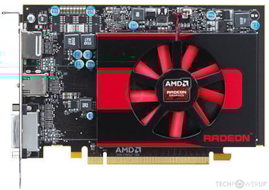

Hi guys, I’m just getting started with Linux on my PC, currently using an HD 7750 since my GTX 770 got roasted by a bad PSU - Is there anything I should know for getting it running smoothly? I’ve only tested a couple games so far, it works fine with BallisticNG, but I get intermittent freezing in Planetary Annihilation… sometimes it works fine, sometimes it freezes after a minute, sometimes after three. Even weirder, if get into a skirmish first, it won’t freeze for the rest of the session. Trying to figure out if it’s a problem with the game or a problem with my computer.
I’m on ZorinOS 15.1 (Ubuntu-based), kernel version 5.4.3. Haven’t messed around with PPAs or anything like that yet.

@FaunCB Okay, I think I figured out what I need to do to blacklist a module, but all the config files are read only - should I make a new one? Is there a specific way I need to set up the file to work properly? Also, is there a way to check whether AMDGPU or the Radeon driver is in use?
Edit: No idea about the 260/260X relation.
lspci -v will tell you what modules are loaded where. You’ll have to scroll up some till you see vga compatible conhroller or something.
Well, lspci lists radeon as the kernel driver in use, so that’s that ruled out. On the upside, I can answer the rebrand question - it’s the R7 250E that’s a refreshed HD 7750 (and so was the HD 8740, for that matter).

Also, for reference, here’s what lspci returned on the card:
Flags: bus master, fast devsel, latency 0, IRQ 55
Memory at e0000000 (64-bit, prefetchable) [size=256M]
Memory at fcf00000 (64-bit, non-prefetchable) [size=256K]
I/O ports at f000 [size=256]
Expansion ROM at 000c0000 [disabled] [size=128K]
Capabilities: <access denied>
Kernel driver in use: radeon
Kernel modules: radeon, amdgpu

But it looks like you’re not running the Mesa amdgpu. You’re on GCN Gen 1, so you’re SOL, because GCN Gen 1 is only “stable” with the radeon driver rather than amdgpu. You may as well get a RX 570 4GB, because the 7750 is not designed for modern Mesa at all.
