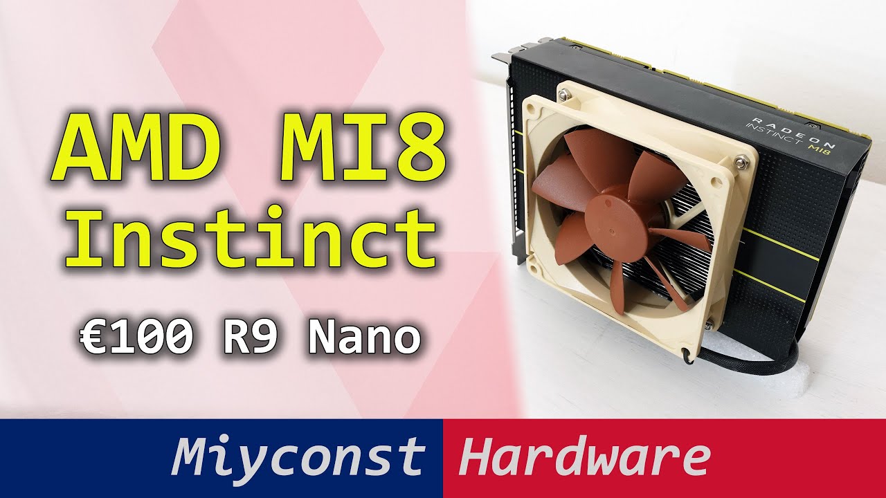

If you’re still interested, an MI8 is an R9 Nano but even more obscure.
The MI25 is Vega 64/WX9100

I notice a distinct lack of video outputs on the Instinct cards displayed. How does one get around that issue? I do recall a thread about someone doing the same with a Nvidia Tesla, but I’m not sure the same method would work with AMD & Linux.
The instinct cards have one, it requires vBIOS flashing and cutting part of the bracket out of the way.
If I remember right, the MI8 doesn’t require a flash. The MI25 certainly does as I found out for myself. The videos already posted sure would have answered that, but whatever.
Neato. So is the mini-DP port already there, lurking behind the bracket? Or did you have to solder it to some traces on the board?
Did i mention soldering? No, I did not solder ANYTHING.
