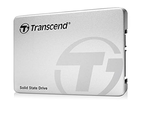

Here is the ssd I have in mind:
I wanted to know, first of all; how much faster that would be then having windows on a normal harddrive? Like how big of a speed boost would it be. Secondly I would like to know alternatives to that SSD. I would be willing to pay a bit more if there is a different SSD I should get that would be faster. Last thing, once I install windows onto the SSD is there a way to kind of lock the ssd so I can't install other shit onto it? I basically want windows, and windows only on the SSD.

You should read SSD reviews. However, don't you think that 120GB is a bit small? You can easily grab larger SSD on Amazon when they are discounted, if you don't mind using another brand. Crucial and Transcend are often discounted. Keep in mind though, that for some reason Transcend SSDs have a lesser write speed, the smaller they are. I picked up this SSD for about 100$. That being said 100$ is significantly more than 40$.

The SSD you linked is a bad unit. It is cheap and using a type of flash that is not reliable and not known to last for more than a couple of years. It is TLC Nand flash, and TLC is not reliable. Look for MLC, or the one expection to good TLC which is samsung's EVO drives, and only that exception.

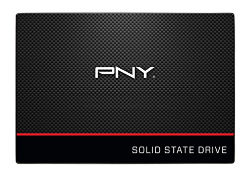

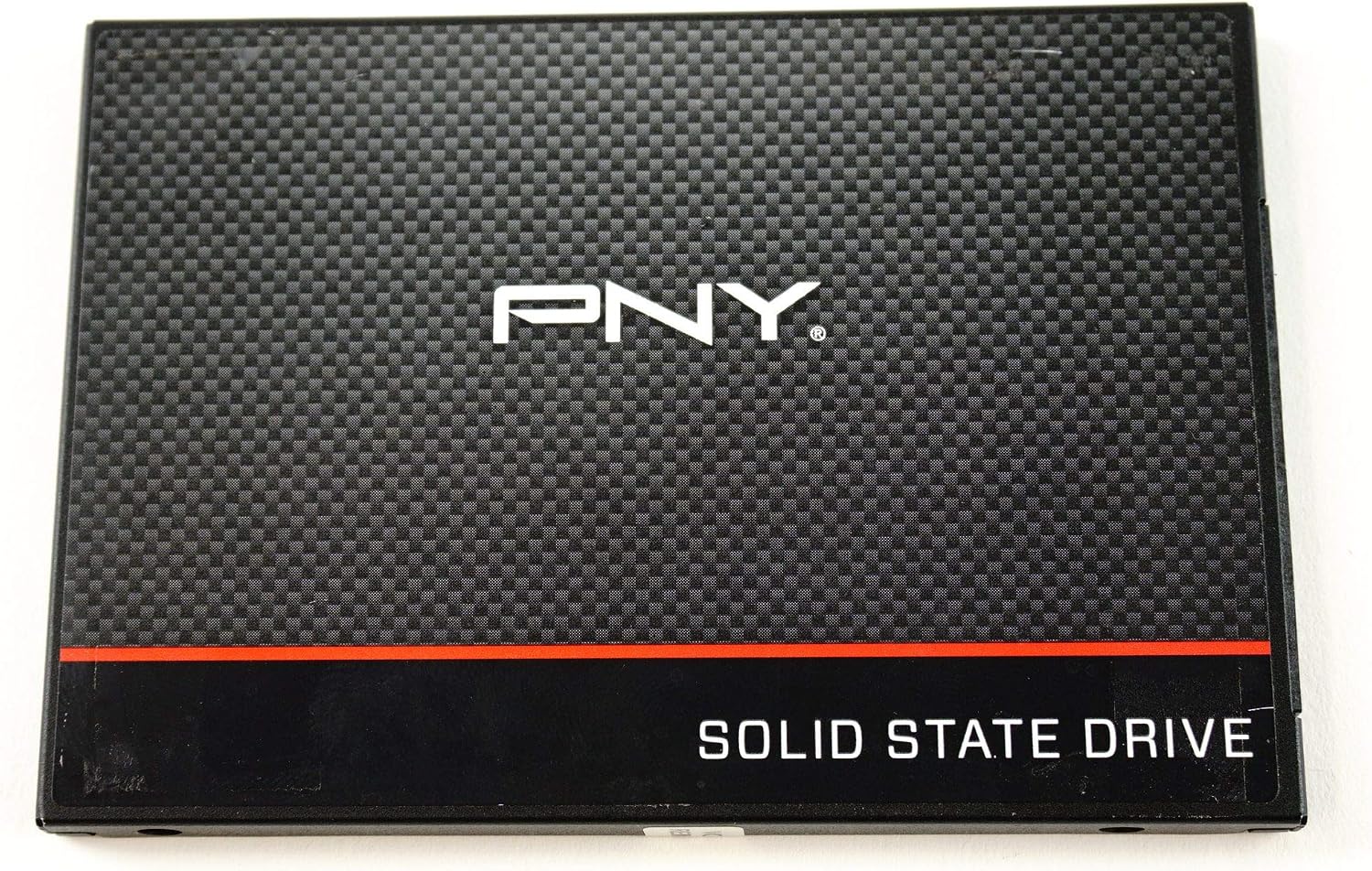

I would recommend rather something like this from a more reputable SSD manufacturer. It features MLC rather than TLC which is more reliable in the long run and plenty read performance.
