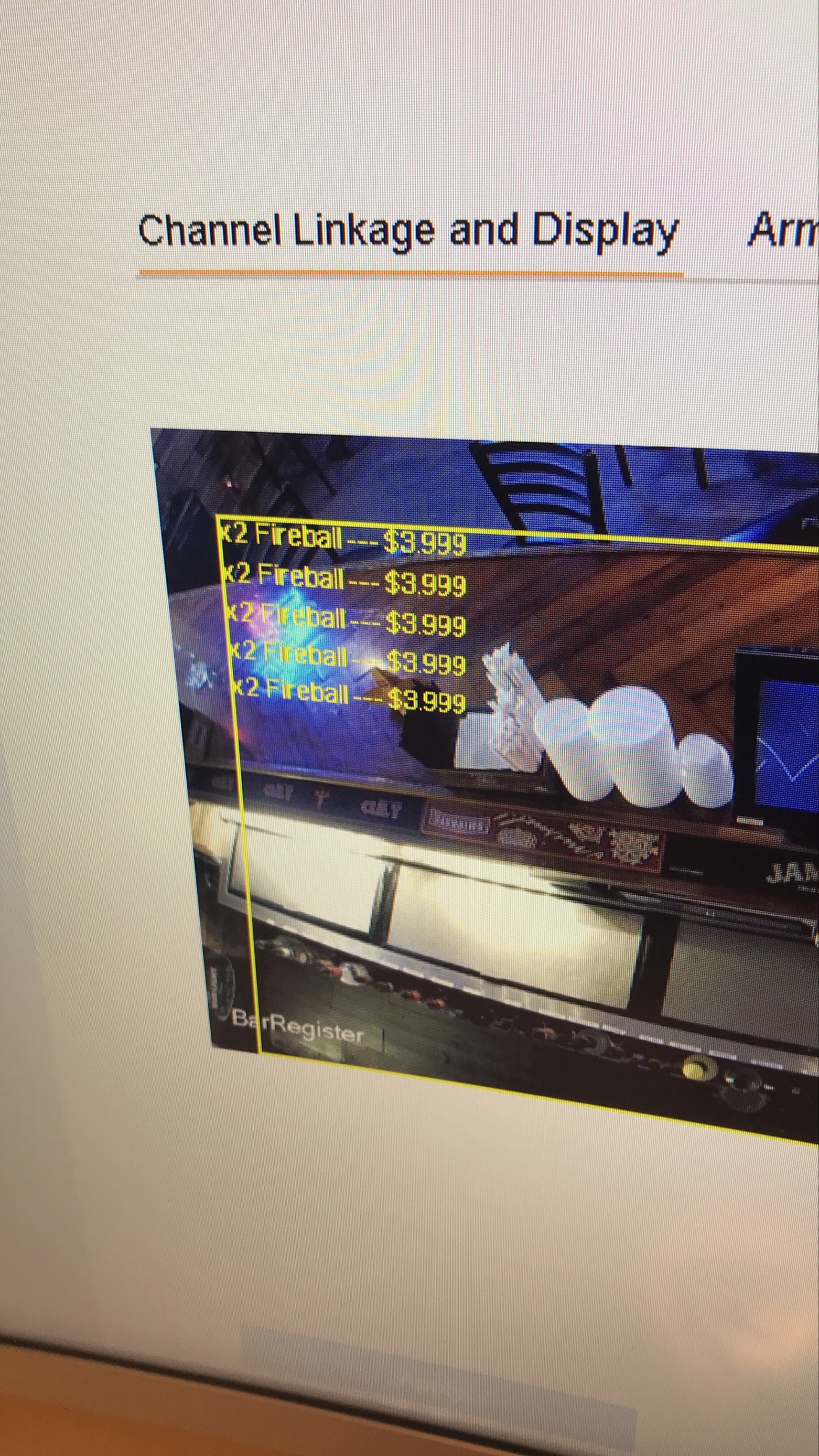

Success!
Had to use UDP server mode. Was pretty tough to figure out due to the converter being Chinese as shit, but I found that they had a testing software which helped a lot
