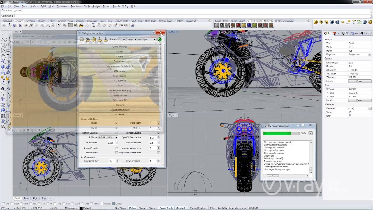

http://docs.chaosgroup.com/display/VRAY3/GPU+Rendering
http://help.chaosgroup.com/vray/images/stuff/rt_gpu/
Some more stuff, that's open CL on like a 480 GPU, which is kinda funny since Nvidia's open CL support sucks, but it seems to run well in that test

It has both. There is an option to select to use OpenCL or CUDA in VRAYS RT Engine.

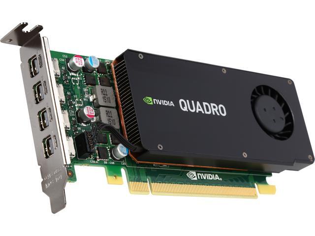

It doesn't look like quadro has a bridge slot, so it probably just does all the multi-GPU stuff over the PCI-e bus, much like the newer AMD high end cards don't need a bridge
Or it might be that you can only SLI certain quadro cards, I don't see a bridge slot on the K1200
http://www.newegg.com/Product/Product.aspx?Item=N82E16814133587&nm_mc=KNC-GoogleAdwords-PC&cm_mmc=KNC-GoogleAdwords-PC-_-pla-_-Workstation+Graphics+Cards-_-N82E16814133587&gclid=CKbnnq2F-8gCFQIKaQodXy8NJA&gclsrc=aw.ds
The K4200 has bridge slots, though only comes with 4gbs of VRAM if that matters at all, and runs about $800
http://www.newegg.com/Product/Product.aspx?Item=N82E16814133558

should work from the look of this

I found a video using the W8100 in VRAY

VRAY supports both AMD and NVIDIA GPUs.
