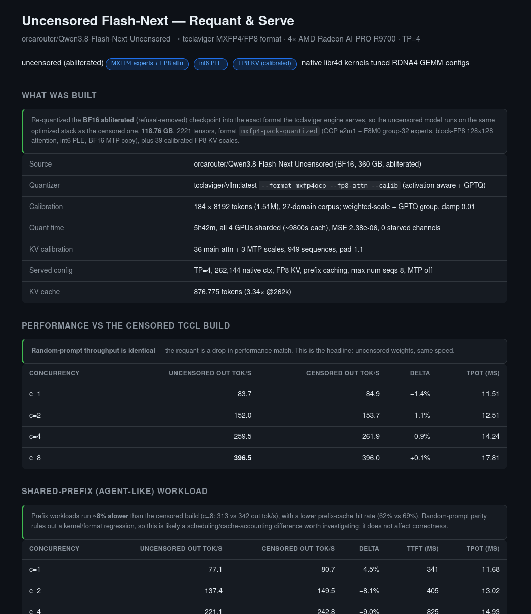

Lets see if i can make an mxfp4 quant from the orcarouter version and mash it into the clavviger engine: https://www.youtube.com/watch?v=hFDcoX7s6rE
OK well its doing ….something, i have a feeling this will take a while
[AA] first layer took 9m55s; estimating 7h56m for 48 layers → finishes ~00:38:46
[AA] layer 0: 1539 modules (1516 with stats), 2 stage(s), capture 100.6s recapture 85.8s quant 234.8s fwd#2 74.9s io-wait 0.0s, E-moved 0, micro-batch 4

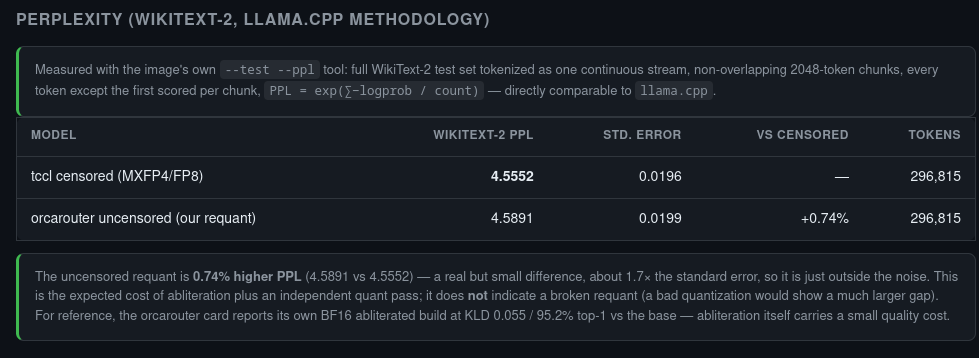

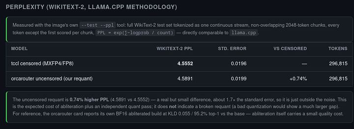

Stretchgoal accomplished XD, requanting isnt as hard as i though performance is near identical but now i can ask it about the uyghurs
I’m going to make a version of the qwen 3.8 27B next on mxfp4 using this engine too, i feel like i can finally use these cards to their true potential all of a sudden XD
I think this means i did it good :stuck_out_tongue:

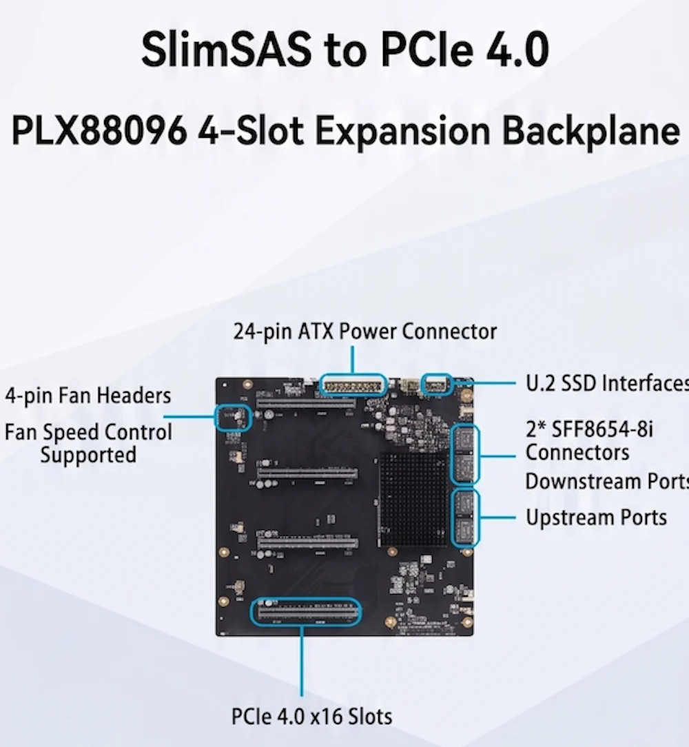

If you install the ROCm Validation Suite, you can use the TransferBench tool to test the p2p speed GPU to GPU and GPU to CPU.
I didn’t have any issues getting p2p to work with Proxmox, but the speed was a lot lower than when running the same tests bare-metal.
Ah i know transferbench, thats how i know its still root-complex routing rather than the PCIE switch, now that VLLM and MXFP4 are sorted its my next target to fix :smiley:

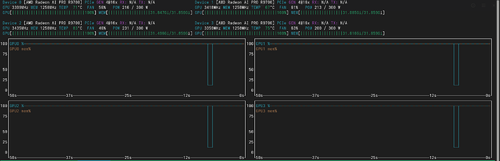

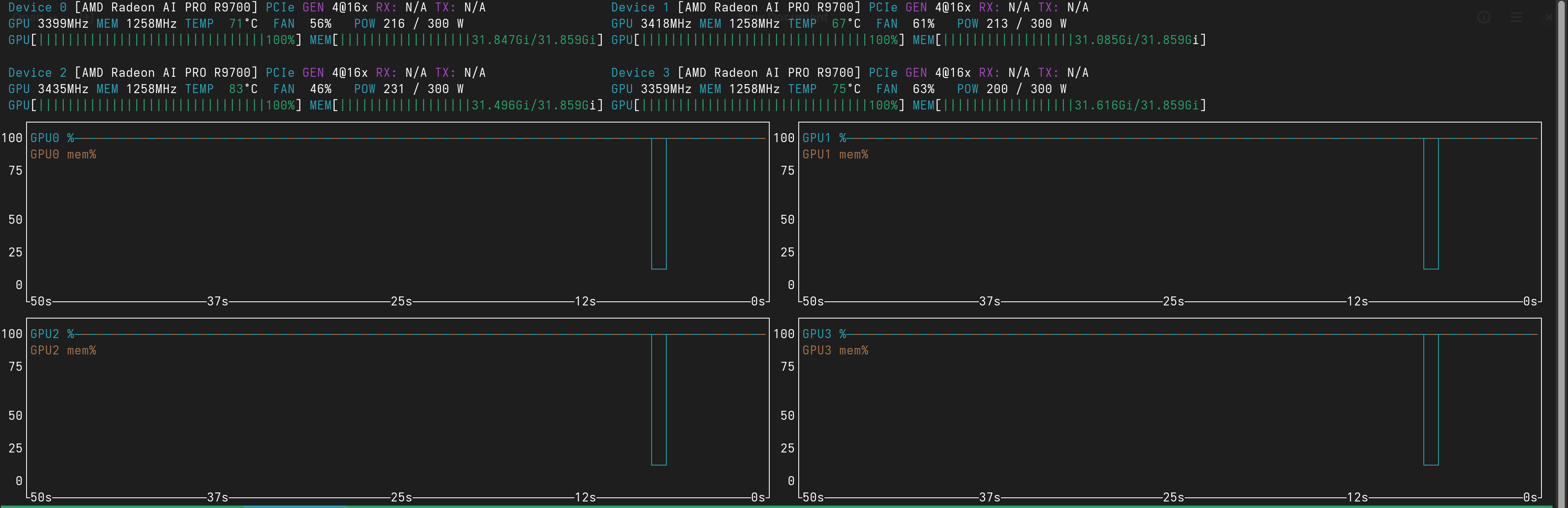

Chatterbox+WhisperLarge+qwen 3.8 flash next configured at C8 with an 850k shared context pool, I’m maxed to the hilt, Atleast i’m not leaving anything idle
AM4 ‘s bottlenecks really don’t bite as hard as i had initially thought if you plan around them properly

I’ve got this board (same switch chip)
but GPUs (same like yours 2xR9700) are being downgraded to Gen3 speeds and stuck there.
(p2p works with acs quirk and kernel patched to make ReBAR usable, +30% pp and not much on tgt front compared to no p2p when on Gen3 host root ports)
Can you attach whole ‘lspci -vv’ output, please?
Are there any tips to make negotiate/force Gen4 speeds.
(host is Gen3 (difference from you), which is fine as long as it negotiates Gen4 for x8 NIC in switch slot, but for some reason it drops to Gen3 for GPUs).

are you baremetal or behind Qemu?
proxlspcivv.txt (309.9 KB)
qemulspcivv.txt (57.0 KB)
I’ve attached my proxmox lspci for you and my qemu as seperate attachments
Also i was stuck at gen 3 for a bit as well, but a reboot and cold start cleared it and it hasnt popped back up since

@flockman thanks for lspci dump, I’m so far bringing this up on bare metal, since i have spare rig for the toy.
