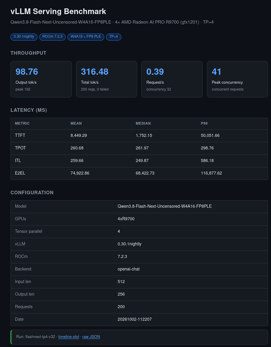

ok so i’m loaded to 82GB of host RAM and around 110GB of VRAM with a GPU kv cache of 500k,
it runs but theres some weirdness:
100 tk/s in concurrent which is …..fine and might be expected considering n-gram streaming from ram, however:

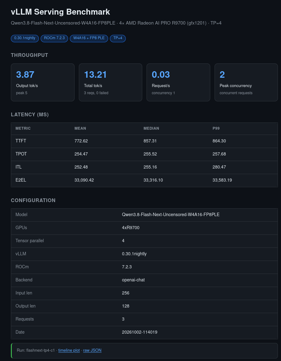

Single user drops to a paltry 4 tk/s, investigating further

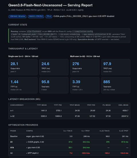

turns out i had some debug flags enabled that caused the graphs to get rebuilt per token, I’m at 27.5 tg/s single and 300 tg/s concurrent now

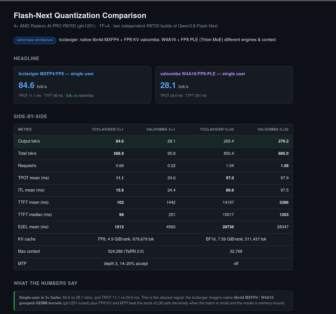

Have you taken a look at tcclaviger/Qwen3.8-Flash-Next-MXFP4-FP8-GPTQ on huggingface? The big strength of the R9700 is FP8 matrix multiplication so you want to avoid W4A16, which is best for older Nvidia/AMD hardware.

Heres my current Flash-next benches, MTP made things much worse

Oh just realized that screenshot you just sent was with tcclaviger/vllm:latest and still didn’t give good results, right? I doubt changing the model will make a big difference, but maybe you’ll get lucky.

ok its loading the model…..loaded…….benching…… it uses a lot less ram/VRAM, performance is good too at around 250-300/s ish, MTP drafting acceptance is low but the throughput isn’t materially worse for it,
also they added the fp8 kv cache that lets you basically double the context for a certain amount of VRAM usage
Single users is a whopping 3X improvement at 84 tk/s
they even enabled yarn for 0.5M single user support, MTP hurts more than it helps, going to disable that next

Man i’m getting 900K of max KV cache too and i still have about 12 GB of vram left over

yeah the censorship is lighter than imagined, you have to push it, I do hope someone can make the uncensored version of this on the same base still though, this container is straight up magic on AMD R9700, i’m getting single user in the high 80’s
