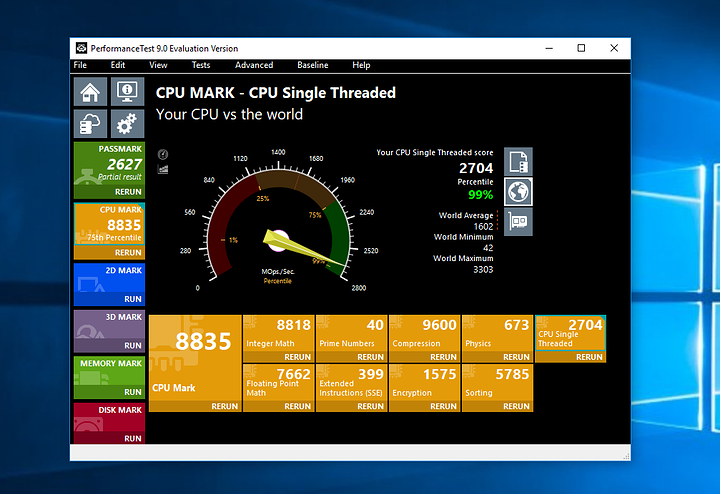

Tried multiple CPU set-ups manually, but I cannot seem to break through the 8800 CPU MARK when benchmarking in the VM, which is very low for my 8600K.

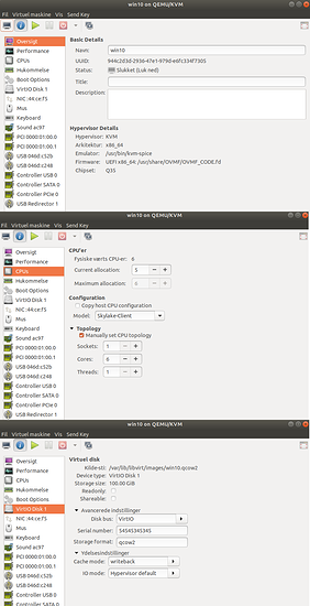

Here is my VM set-up in Virt-Manager:
Anyone got any ideas why my CPU is not utilized?

How am I supposed to “leave” cores for the host?
All I can set in Virt-manager is how many CPU (which is cores I am guessing).

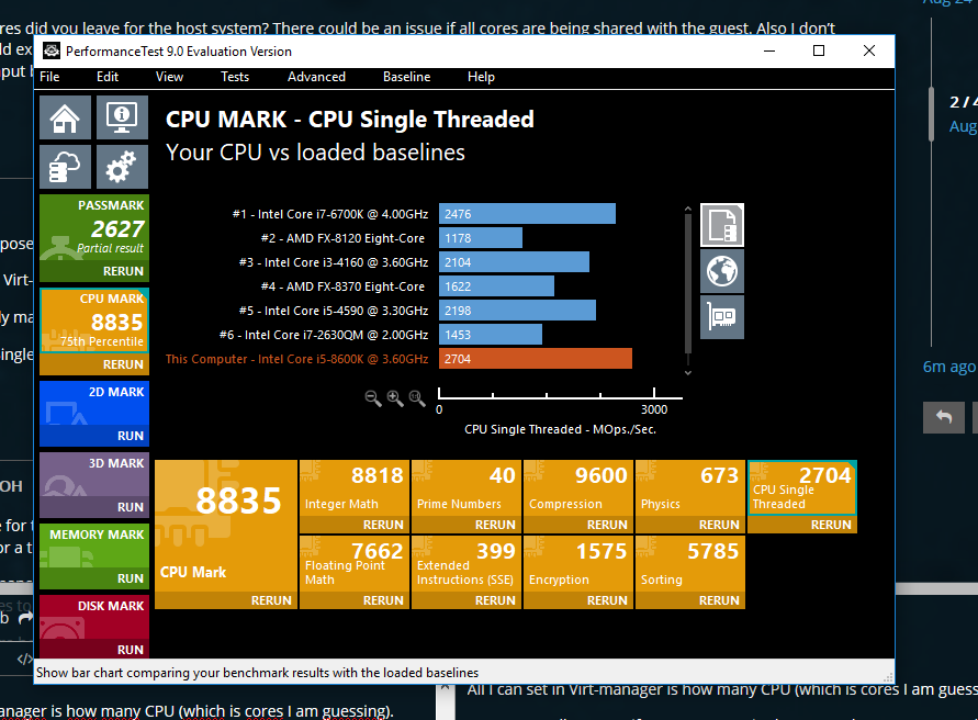

Does not really matter if I set 1 - 6 or as in the screenshot 5 - 6, I can only get worse performance, never get above 8800 CPU Mark total.
However on Single thread it is performing excellently, so maybe I am just reading this all wrong?
You leave one for the host by allocating 5 cores for the VM in the CPU page of virt-manger. Then the VM will use 5 cores and leave one for the host for a total of six cores.
As for performance, natively on windows it is like 16,000ish on PCU mark? If so then you should not expect more then 13,333 if you allocate 5 cores to your VM.
As for the score being under 10,000, for initial config tweaks I would recommend you take a look the the performance tuning section of this Arch wiki page-
