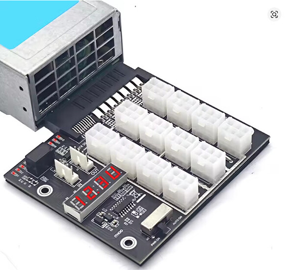

You also can go the maker path and use a 1400W+ server PSU with one of those breakout boards that the crypto mining guys use.
If you choose that path, be aware that the boards are not all equal.
They are more or less tailored for the PSU power rating and size of the connector.
And you might need those PCIe extension cables, if your building in an open chassis.
It’s a funky solution that arises some controversy but it’s effective and “cheap”, when compared to the standard solutions.
