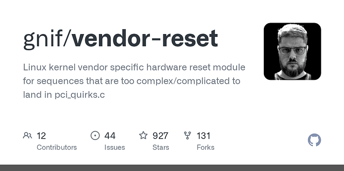

So the Vega 64 has the reset bug.
Fortunately, gnif and belfrypossum have figured out workarounds that are working fairly well. The patches that you may have seen are obsolete, because they are superceded by the vendor-reset kernel module. The upside compared to a standalone patch is that with a module you do not have to recompile the entire kernel, you only have to build the module and add it in to your current kernel.
So basically, figure out if unraid or proxmox is more friendly to adding in kernel modules. You will need to install the kernel headers at a minimum, and DKMS would be good as well.

Proxmox probably makes the most sense if for no other reason than the 40 bucks or whatever the entry license costs these days for unraid. Also the Unraid thread proposing adding the reset bug header fix for Vega to Unraid 6.8 went cold and I don’t see anything about it in the release notes. But it MAY work out of box on the newest unraid? (It will still not help whenever a VM crashes, etc. so you’re still going to be dealing with hw resets).
So you think they are equally prone to crashes as far as running two VMs simultaneously goes?
Oh it’s not about crashing because you’re running two VMs simultaneously. It’s about the Vega GPU not resetting itself properly to re-start a VM in general without a hw reset. It’s everything to do with those particular GPUs being less pleasant to work with in VM environments.
AFAIK - the kernel module that was referenced at the top of the thread mitigates the issue, but it doesn’t resolve it. If your VM doesn’t successfuly shutdown properly thaat won’t help.
