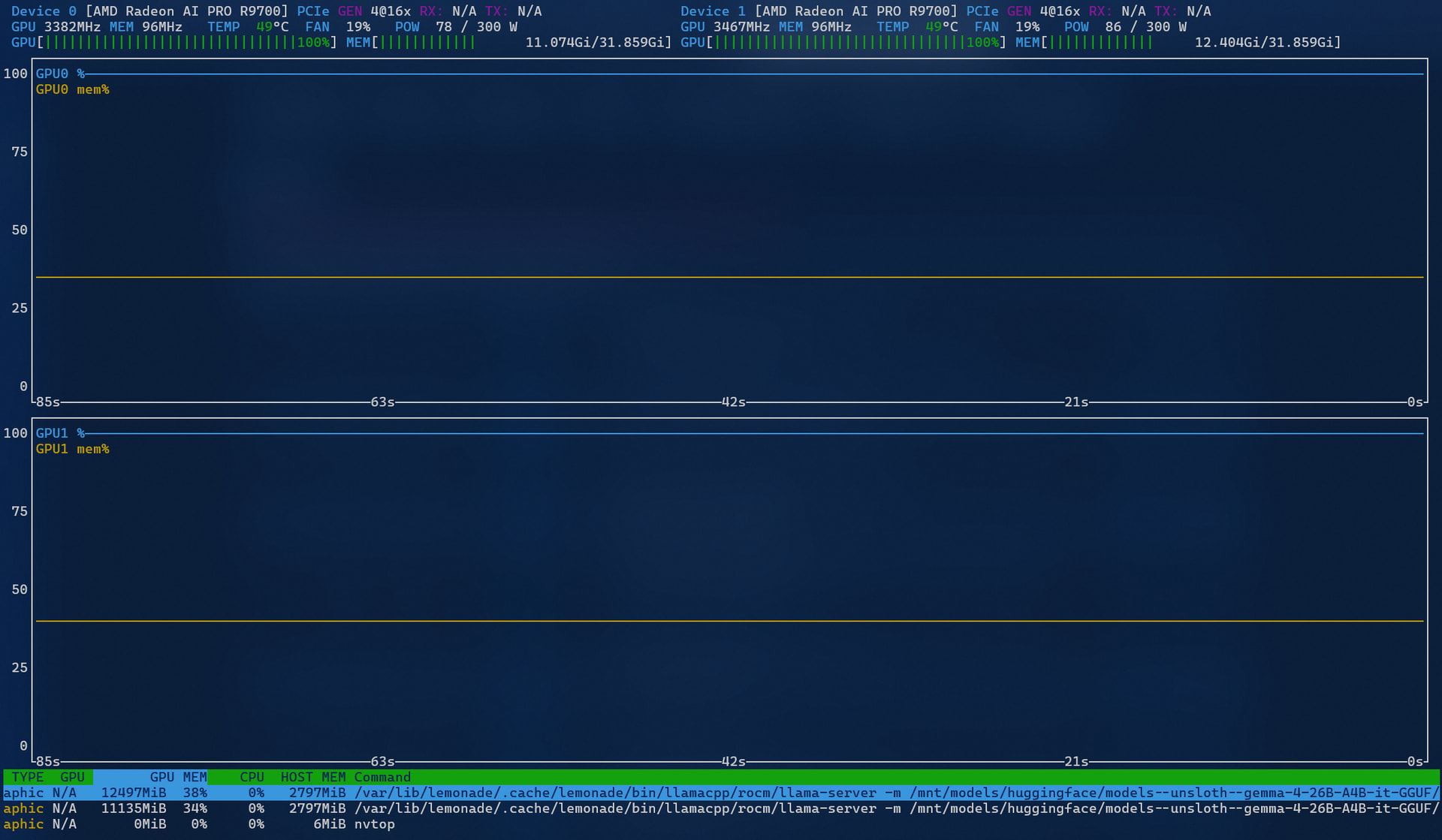

Here’s a convenience script I wrote for adding GPU’s to an LXC. In this case 2xR9700. Depending on the base OS image groups, you may need adjust gids.
#!/bin/bash
# Usage: ./add-gpus.sh <VMID>
VMID=${1}
if [[ -z "$VMID" ]]; then
    echo "Error: Please provide a VMID (e.g., ./add-gpus.sh 100)"
    exit 1
fi
# Verify the container exists
if ! pct status "$VMID" >/dev/null 2>&1; then
    echo "Error: Container $VMID not found."
    exit 1
fi
echo "Adding AMD GPU devices to LXC $VMID..."
# Map the DRI cards (Video Group: 44)
pct set "$VMID" --dev0 /dev/dri/card1,gid=44
pct set "$VMID" --dev1 /dev/dri/card2,gid=44
# Map the Render nodes (Render Group: 109)
pct set "$VMID" --dev2 /dev/dri/renderD128,gid=109
pct set "$VMID" --dev3 /dev/dri/renderD129,gid=109
# Map the Kernel Fusion Driver (Crucial for ROCm/KFD)
pct set "$VMID" --dev4 /dev/kfd,gid=109
echo "Done. Please restart container $VMID for changes to take effect."

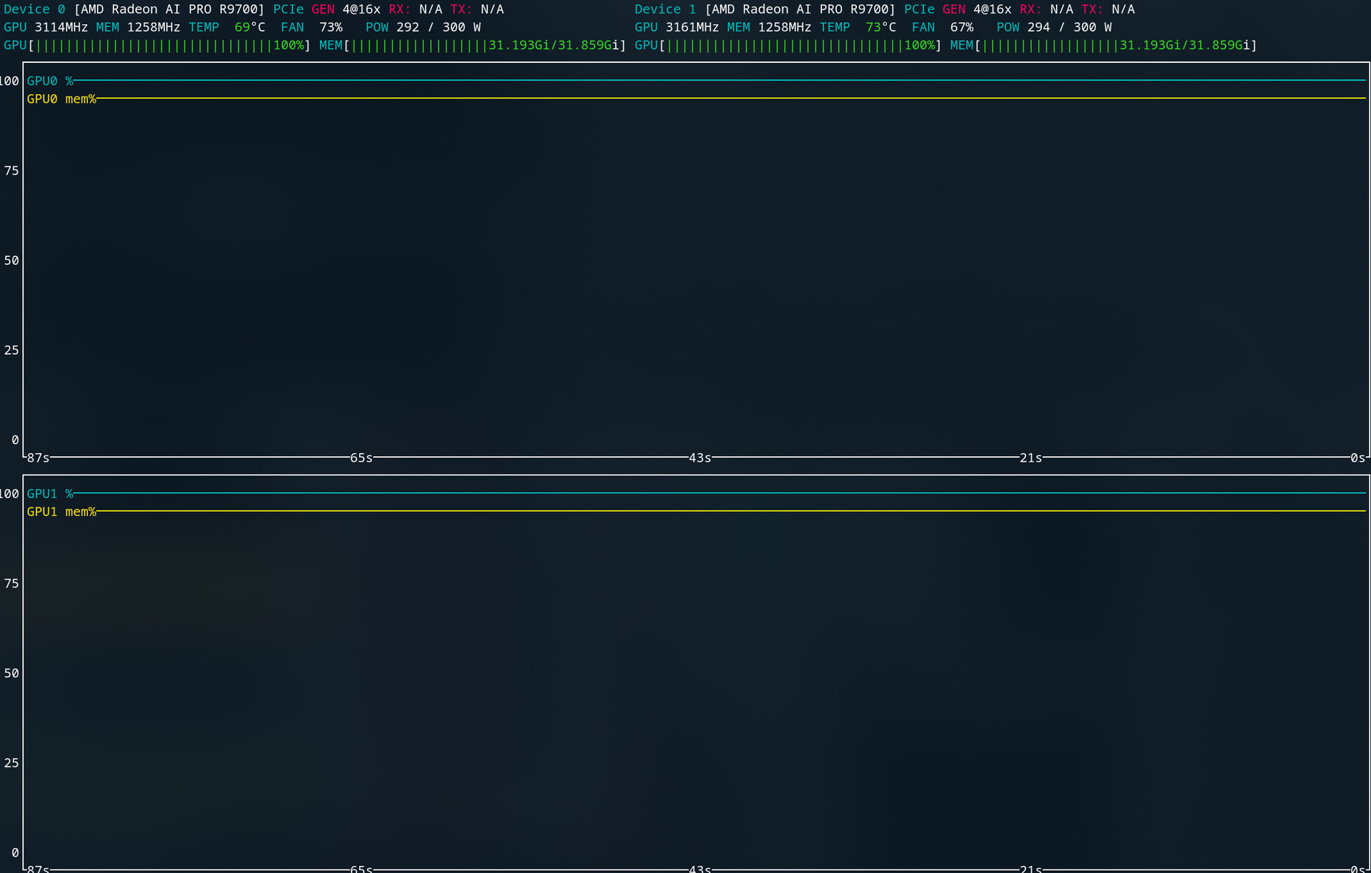

Since the GPUs are shared across LXCs, using nvtop from Proxmox ssh will show all container applications currently using GPUs.
My vllm instance running Qwen/Qwen3.6-35b-a3b-fp8
Throughput: 5.68 requests/s, 6546.32 total tokens/s, 727.37 output tokens/s
Total num prompt tokens:  1024000
Total num output tokens:  128000
These kernel parameter still need tuning
N=8192,K=5120,device_name=AMD_Radeon_R9700,dtype=fp8_w8a8,block_shape=[128,128].json
N=5120,K=3072,device_name=AMD_Radeon_R9700,dtype=fp8_w8a8,block_shape=[128,128].json
N=17408,K=5120,device_name=AMD_Radeon_R9700,dtype=fp8_w8a8,block_shape=[128,128].json
N=5120,K=8704,device_name=AMD_Radeon_R9700,dtype=fp8_w8a8,block_shape=[128,128].json
N=7168,K=5120,device_name=AMD_Radeon_R9700,dtype=fp8_w8a8,block_shape=[128,128].json
