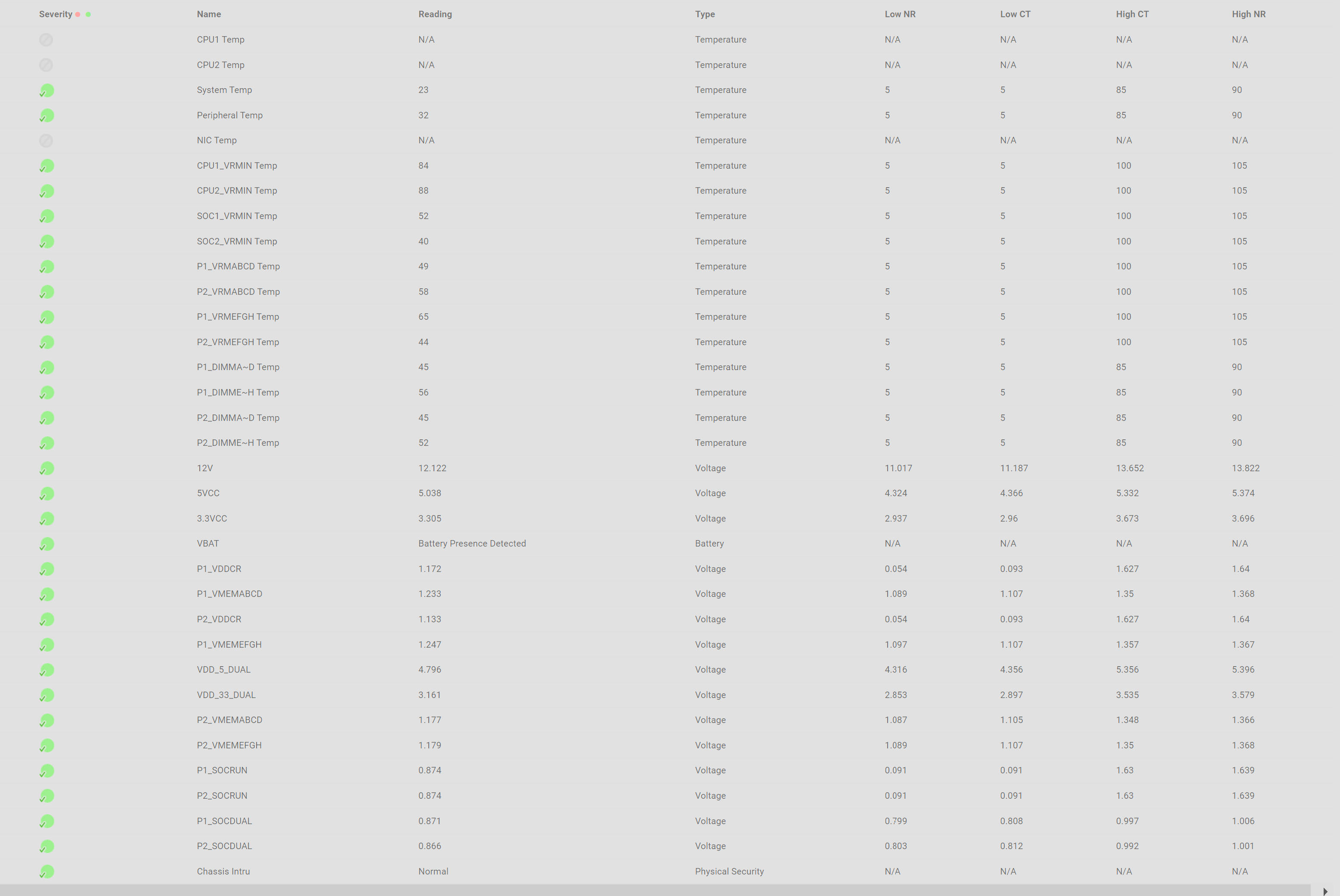

The IPMI screenshot below was taken after about 25 minutes mining with a cTDP limit of 260w set in the BIOS.

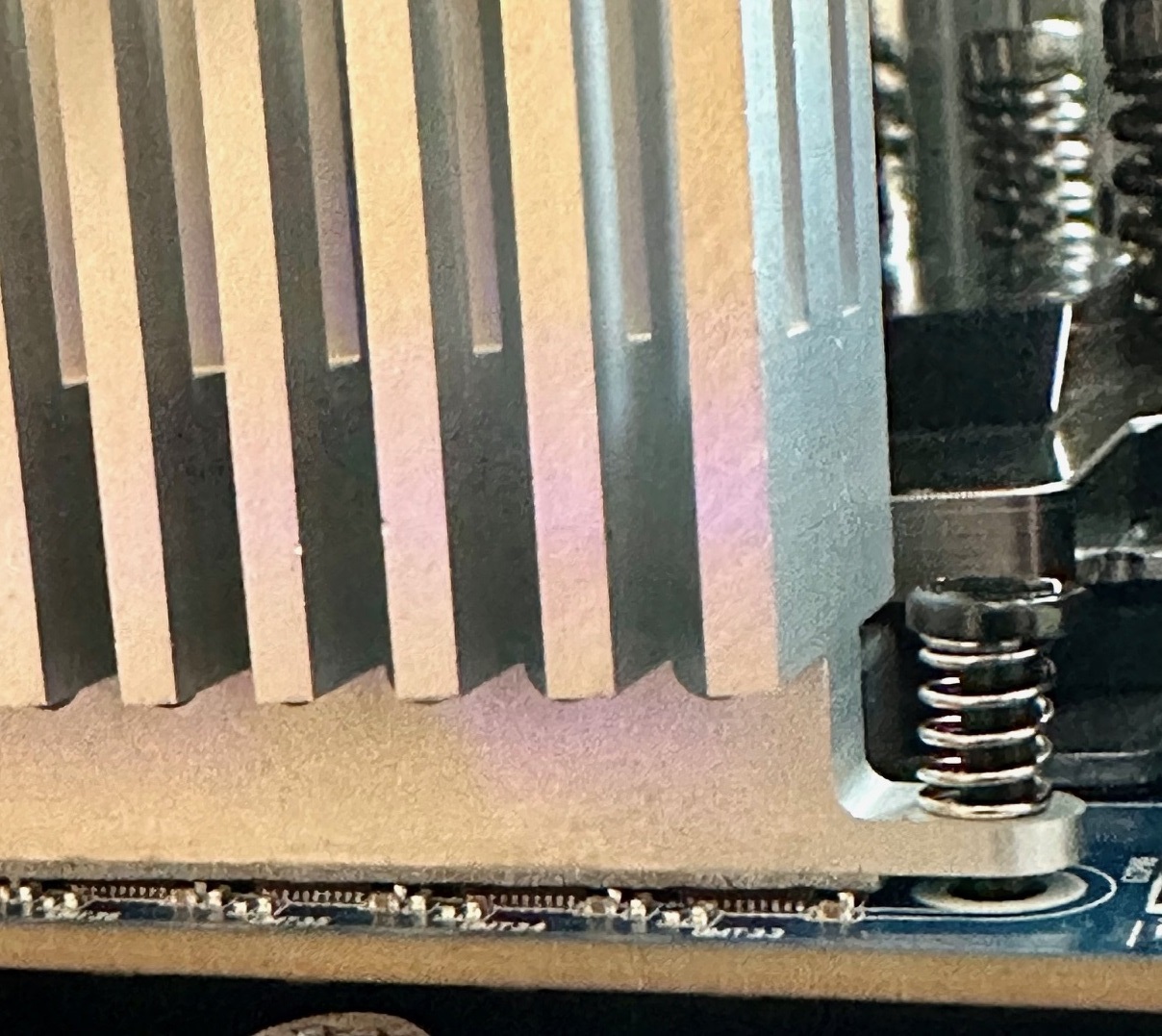

The vram heatsinks for my board were found on Alibaba, they are much bigger and more effective than the stock ones and fit perfectly.
I also upgraded the TIM putty to the Gelid Ultimate (15w), this keeps everything from getting any higher than body temperature
As for the various hotspots on the board, I used generic amazon bought heatsinks (similar to the ones that come in RaspberryPI kits)
My CPUs, in my case the 9684x and for the other board the 7773x, can get warm when running max and all-core, so I had to take extra steps.
