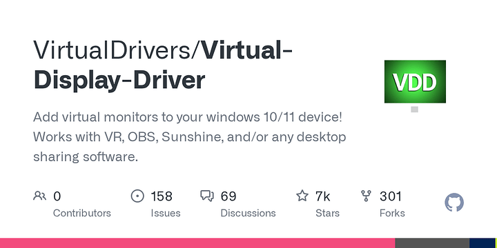

Not sure if I’m the only one that uses TightVNC as their go-to remote desktop server for test Windows VMs, but for some reason it does not currently work with the recommended guest drivers here when the VM is configured with only the B50 VF for graphics. It will work during setup with VGA+VF, but as soon as emulated graphics is removed to get full performance the client only gets a black screen. Use RDP.
You might need to add a virtual display for VNC:
Hey, that worked. Thank you!
