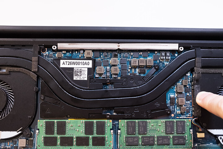

Decided that it might be easier to get a second hand heatsink, and desolder the heat pipes and fins, instead of starting from new. The blocks are the main problem, IMO. Might add a 50mm long heat pipe to move more heat away from the CPU, but positioning will be weird.

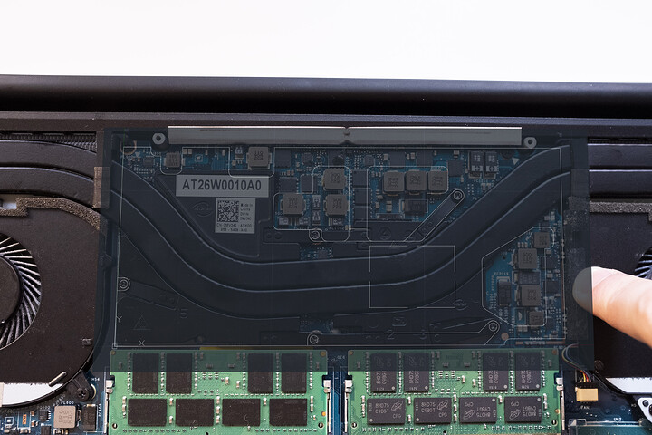

Noticed that no one’s measured the temps of the ICs on the right hand side, where they’re normally covered by a little EM shield type thing.

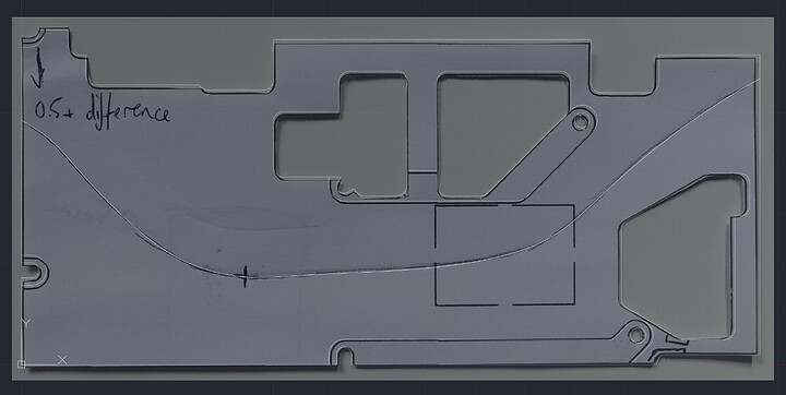

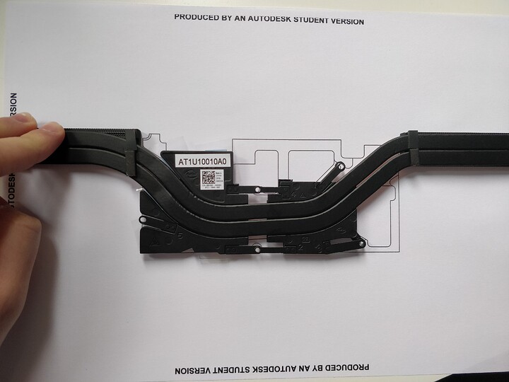

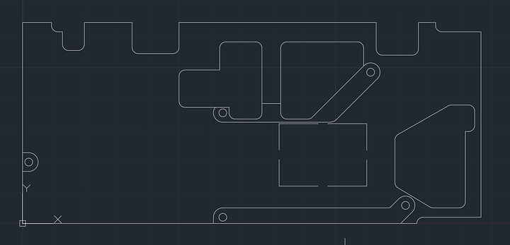

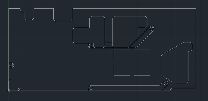

Going to print this first drawing to scale, and then make any corrections. I’ll try and get a quote to get that CNC’d tomorrow once it’s finalised.

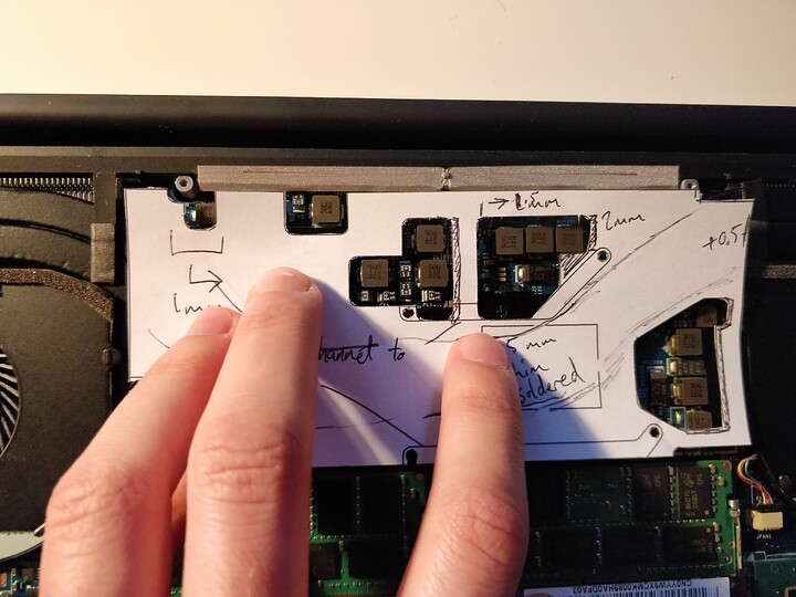

Looks like I’ll need to widen the cutouts by a couple of mm.
Cut out a template, and made the adjustments based on that. I’ll check this one in a bit, and add a groove for the heatpipes to sit in.
Once I have everything in the right place, I’ll put the drawing into SolidWorks and see how it looks. Can potentially try a thermal simulation with it.

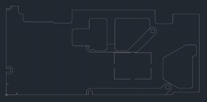

Extended the top corner, and added a notch for one of the motherboard screws to hold it down. Got rid of any material which was in the way, and slotted the outer screw holes.
I’ll finish the drawing off tomorrow morning.

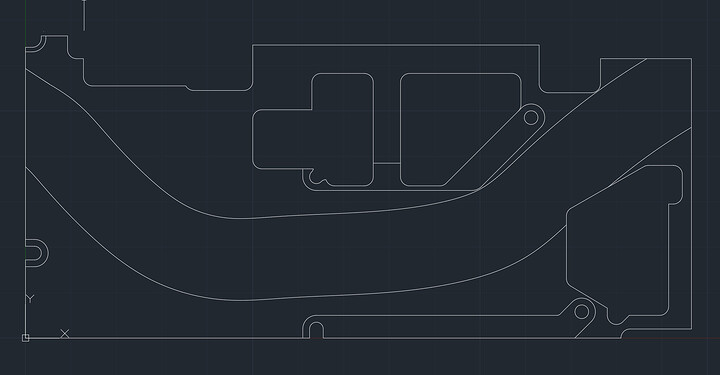

Very technical way of doing the slot for the heatpipes. Marked the centre line on a template, then took a photo and overlaid it in AutoCAD. (What’s a scanner?) Then just offset the line each way.
A bit of a gap shouldn’t matter too much, as it could just be filled with solder.

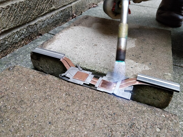

Hopefully they’ll be fine if I continually move the blow torch. Think the best thing to do might be to cover the channel in flux, cut up some solder, and place it in the channel between the pipes and plate. Then fill in the sides once it’s dropped into place.
The difficult thing will be stopping the fin stacks from falling off the ends while doing this.

Found the solution to that problem. Can use low temp solder paste (melts at 138°C). Less chance of rupturing the heat pipes.
Not sure how much web searching you did, but I found this: (no mention of any special solder)
I have not found reports of bursting pipes yet, besides the obvious warnings that it might not be a good idea to heat a pressure vessel. :grin:
Yeah, saw that thread yesterday. Think I’ll have to be more careful with the heating, due to the pipes being a lot thinner on my laptop.
Will probably do what they did and just heat the CPU/GPU mounts, and let the heat pipes distribute the heat. Already worked out how I’m going to hold it all in place when joining it all.

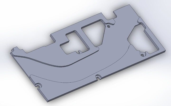

This probably won’t be the final design, but it’s near enough. Weighs 135g.

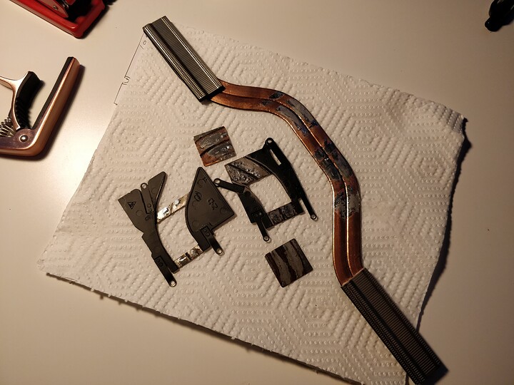

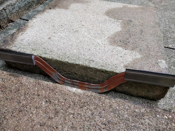

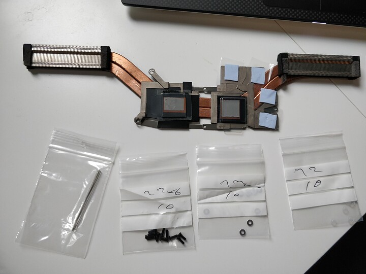

Heatsink, screws, washers and spring turned up. Might try desoldering that today.
Fits the drawing pretty nicely. Just worked it out, and it’s going to be roughly two and a half times the mass of the original (~65g vs ~150g)… Hope the bolts are strong enough.

Worked better than I expected. Fin stacks stayed in place (thanks, horribly cold weather).
