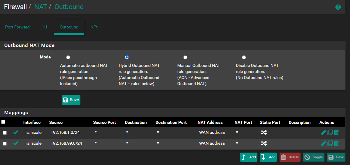

I think something is going wrong with my Outbound NAT, but I am not sure how to fix it. These captures are from the site A router:
Note how in the State screen capture pings from the “1” subnet are going out the WAN interface instead of tailscale0.

For outbound NAT you need an entry for each gateway interface, so WAN plus your VPN interface(s), with a source of each of your local networks. You can probably just copy those WAN rules you already have and change the interface to your VPN interface.

I already created individual outbound NAT rules previously and it did not work. Also if that was required, why does this combined rule work for the “99” subnet?

I think I found the missing piece. Looks like the NAT Address either needs to be “WAN Address” or “Interface Address”.
