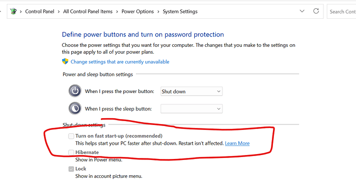

Just had the hanging on shutdown error, the code that it displays is 40 which is normal but trying to wake up from Hibernation. Go into Power settings and set to ultimate performance and make sure you have Hibernation & Turn on Fast Boot un checked… doesn’t affect my boot speeds
thanks so much everyone for the replies.
switched to Ultimate plan, and deactivated all hibernate and wake features and didn’t encountered any other problems regarding shutdown, also it’s much faster than before, so this was definitely a windows issue.
