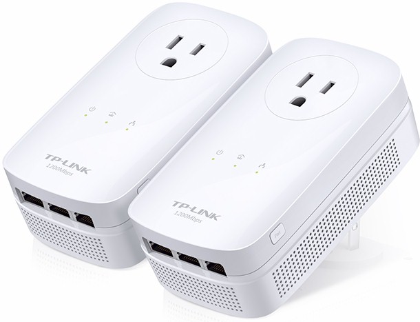

Definitely stay away from powerline, here’s an old post of mine. Basically it’s slow and gets interrupted frequently: Improving Powerline performance - #19 by Log
If you have Coax run through the house, then MoCA adapters + appropriate filters let you run Ethernet over them at least at gigabit speed or higher.
If not, best bet is run cat6 secured along the walls/baseboards. Even if ugly, you’ll very quickly stop caring.
MoCA adapters are the best you can do to extend to rooms that dont have wired ethernet but do have coax. They work extremely well and have the lowest latency out of your typical options between MoCA, PowerLine, and Wifi.
Powerline works great if you don’t have any of the “gotchya’s”, which there are a lot of:
You need to use an “AV2000” product if you are going to use this route at all.
If your house wiring is more than 20 years old, it can have performance problems
If your house wiring doesnt use modern line+neutral+ground then it has problems
If the total distance is more than about 200’ through wires you tend to have performance problems.
If the circuits you are trying to connect are not on the same power phase that goes into your house you have problems
If you have to pass through a GFCI circuit breaker you probably cant use powerline at all
If you have to pass through a GFCI power outlet on the way to the outlet you want to use then you probably cant use powerline at all.
