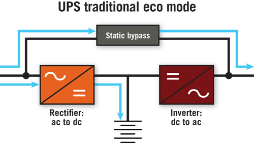

This article may interest you.
http://www.csemag.com/single-article/evaluating-ups-system-efficiency/73497ade33f9a66ead63a77f33e94d4e.html
In eco-mode, many UPSs bypass the rectifier and inverter, but this also means there's no real surge protection.
I was more wondering about when the battery is in use . Mainly concerned with battery life when no ac power is available..
