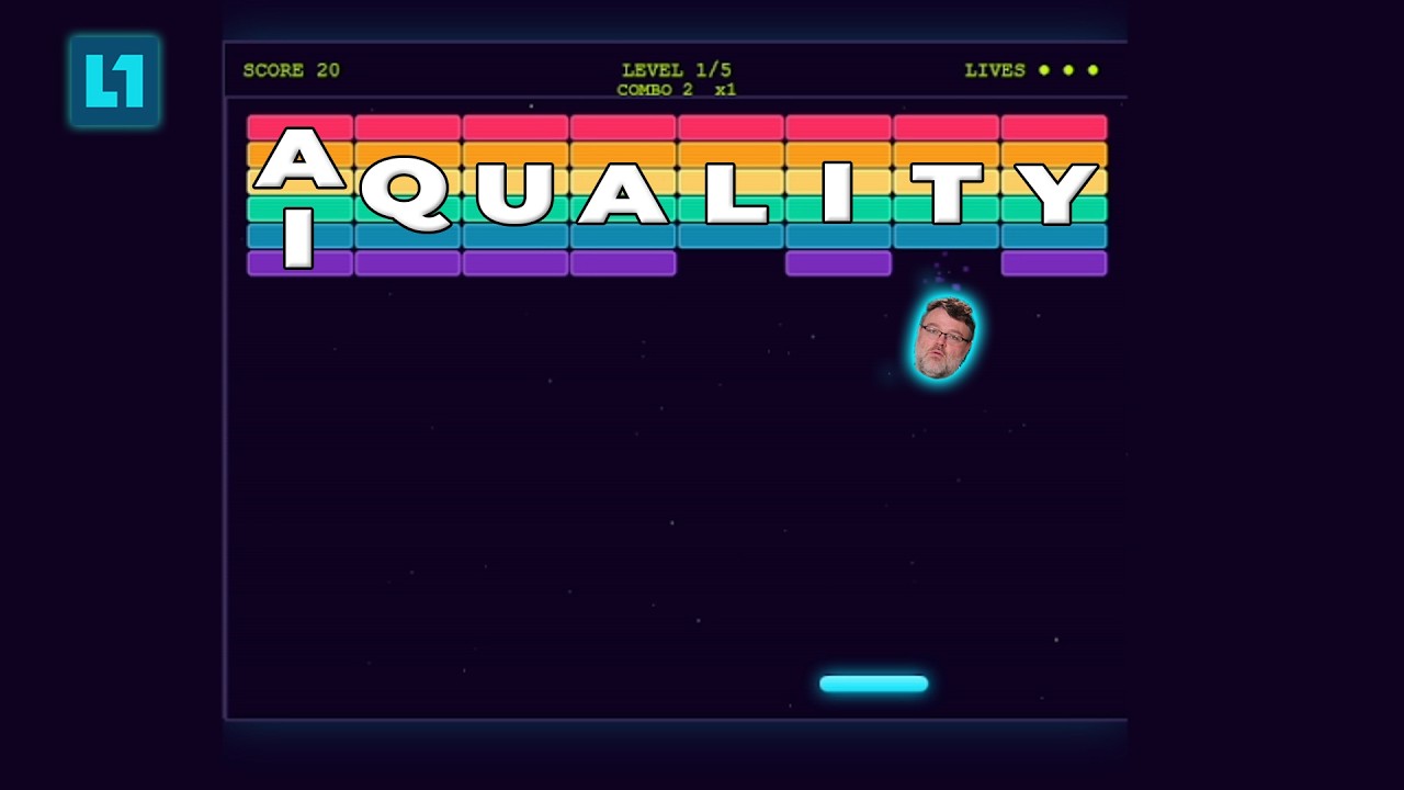

Pow3rtool and nvfp4 and oh my
Qwenfight in Pow3rtool:
https://pow3rtool.github.io/Qwenception/#dataset=sp06&baseline=h200-triton-bf16-bf16kv&runs=b200-triton-bf16-bf16kv%2Csm120-triton-bf16-bf16kv%2Csm121-triton-bf16-bf16kv&range=all&ties=argmax
Spawned from this discussion:
which has led to us doing analysis like this with our “breakout clone test”
^ this is where you can download the differently-configured breakout-clone-output files and bang on the tires a bit.

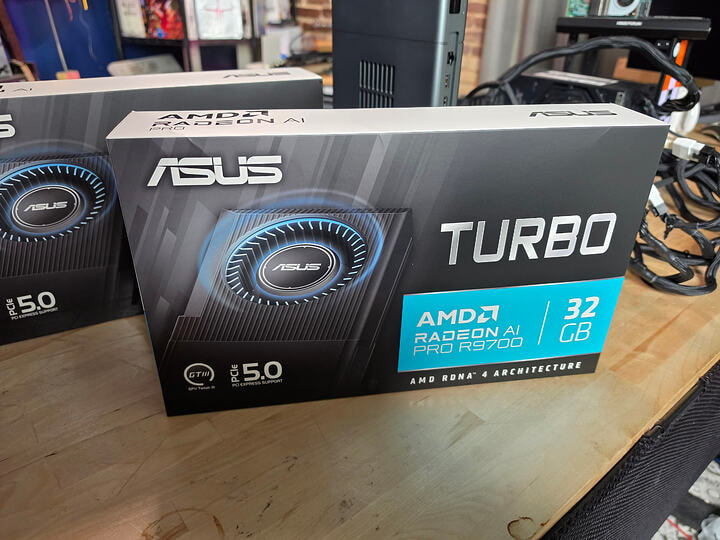

The more I learn, the more it feels like the wild west. Ive got a 4090, 2x B70, and 2x R9700, with a 256g M5 Ultra on the way, and I cant find anything near a guiding principle for what to run on this mess besides “qwen” at anything above Q4, and keep kv at Q8 or more. And only that bit because of a general “this number is smaller when doing it this way, or this go fassszszzt!”.
So, looking forward to this, would love to know what knobs to turn, even if vicariously, for better results. Even if I have to ask hermes to decipher it and ELI5.
Wanting to get turnstone up on my laptop, but dont want to give hermes SSH lol. Looking forward to the video :slight_smile:
