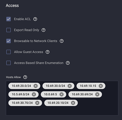

TrueNAS Share Config
![image|314x550, 100%]upload://v450uYBjib3cmp1fv7pli32YX3P.png

From your screenie futher up the chain I would suggest you enable “SMB Multichannel” which came in with SMB3.x (I think ?). That is supported in newer MacOS variants (I’m on 12.7 Montery on an M2 MBP if that helps).

Finally :slight_smile: with TrueNAS I seem to recall reading on their forums that MacOS character compatibility should be ENABLED. That is the “Use Apple-style Character Encoding” checkbox in your screenie above.
