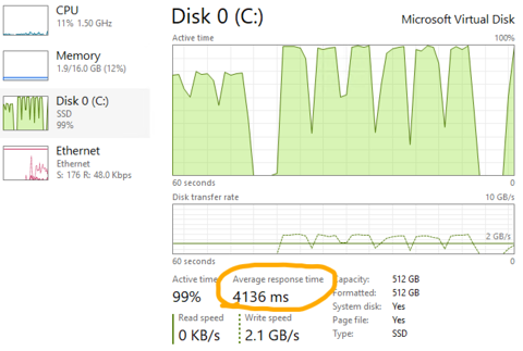

We originally were suffering extremely poor response time when we were in a VM. The x2 Kioxias were in a storage spaces RAID0, everything left to default during setup. We were using fixed size vhdx, with a Gen2 VM. When I used CDM within the VM I got these results:
Seq1MQ8T1 - 3556MB/s - 4139MB/s
Seq128KQ32T1 - 2166MB/s - 2108MB/s
RND4KQ32T16 - 391MB/s - 203MB/s
RND4KQ1T1 - 21MB/s - 22MB/s
I’d have thought that Reads/Writes would’ve been a lot faster than this since no other activity was happening on the array. I took a screenshot of the response time during a CDM run, I had seen the response time go to over 20,000+ms during this run:
