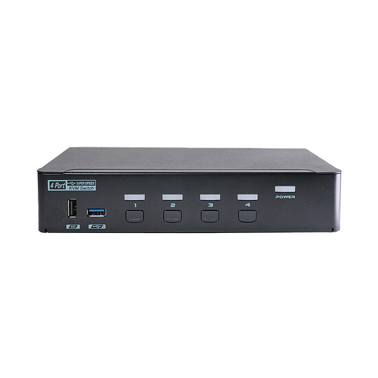

I originally purchased a Startech 4-port HDMI USB 3.0 KVM in 2023 and really liked it - until it started blacking out two of my laptops frequently. I figured it could have been bad HDMI cables and ordered new ones. It did not solve the issue. Their helpdesk had me turn down the refresh rates to nearly 30Hz and it did not really improve the situation. I decided to try a TESmart HKS401-M24 and it is flickering across 3 laptops, constantly adjusting the laptop displays when I switch from input 1 to input 2 and 3 and so on. I tried contacting their helpdesk and they said what I was describing simply couldn’t be happening. It’s even worse now because the monitor will change to 1920x1080 display randomly and makes my monitor practically unusable. I have to play with the 1-4 display buttons a few times before it decides to act right.

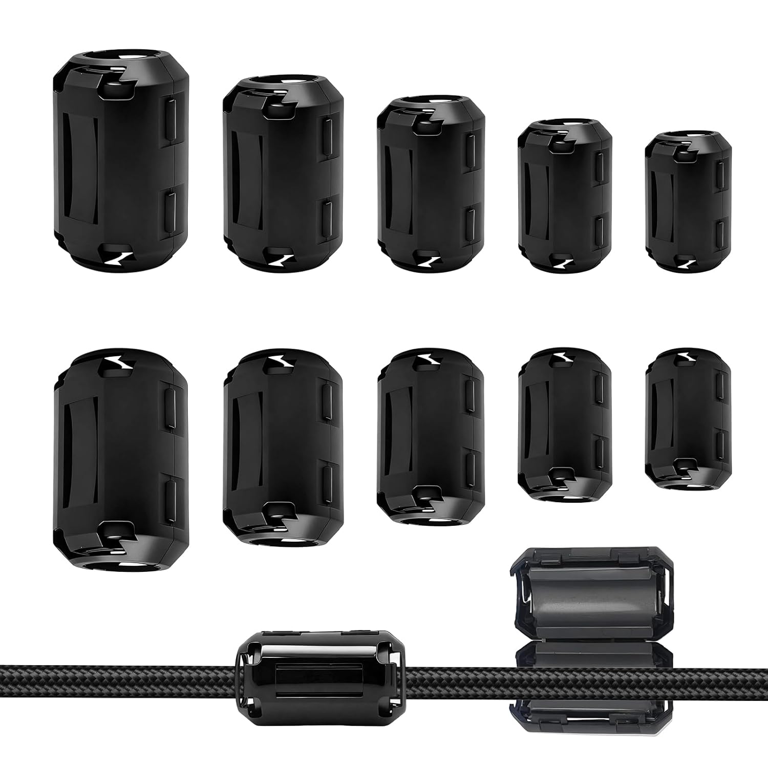

Flashing black screens usually mean there’s a bandwidth issue or interference. Bandwidth issues usually stem from lower-quality cables or cables that are too long.
You could try attaching a ferrite clamp to your current troublesome connections:

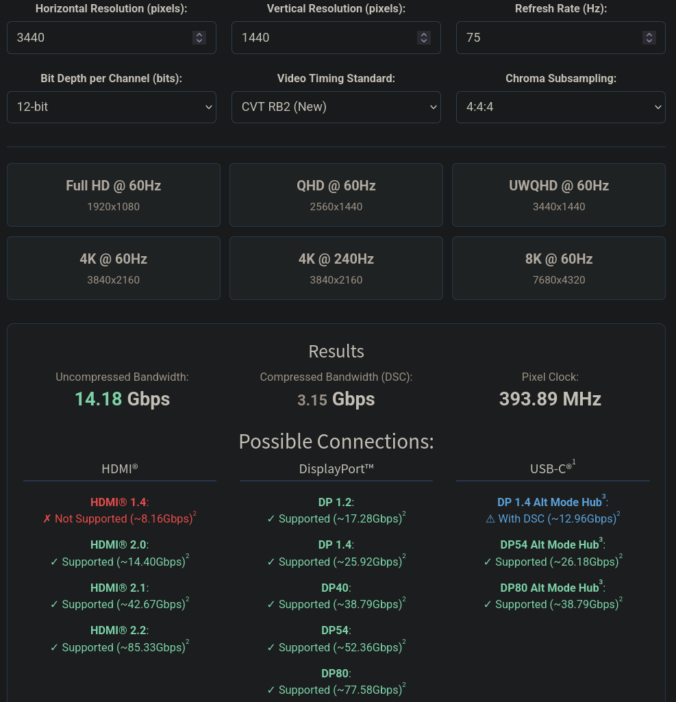

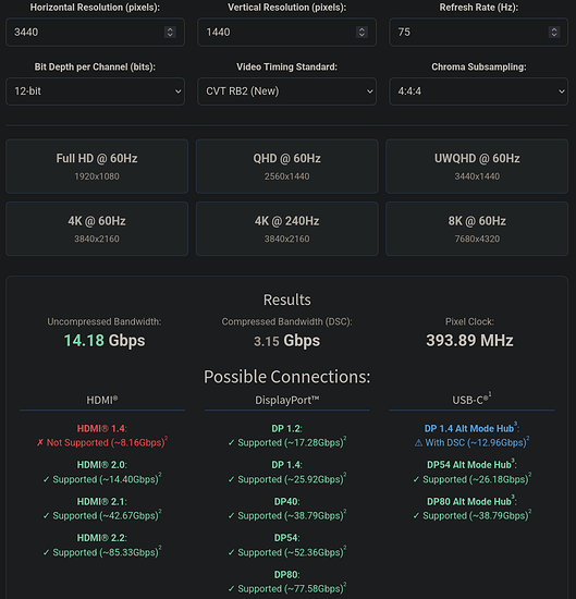

If we plug in the Samsung S34J55W info into our bandwidth calculator, we get this:
I wonder if USBC → HDMI cable is lowering the bandwidth
