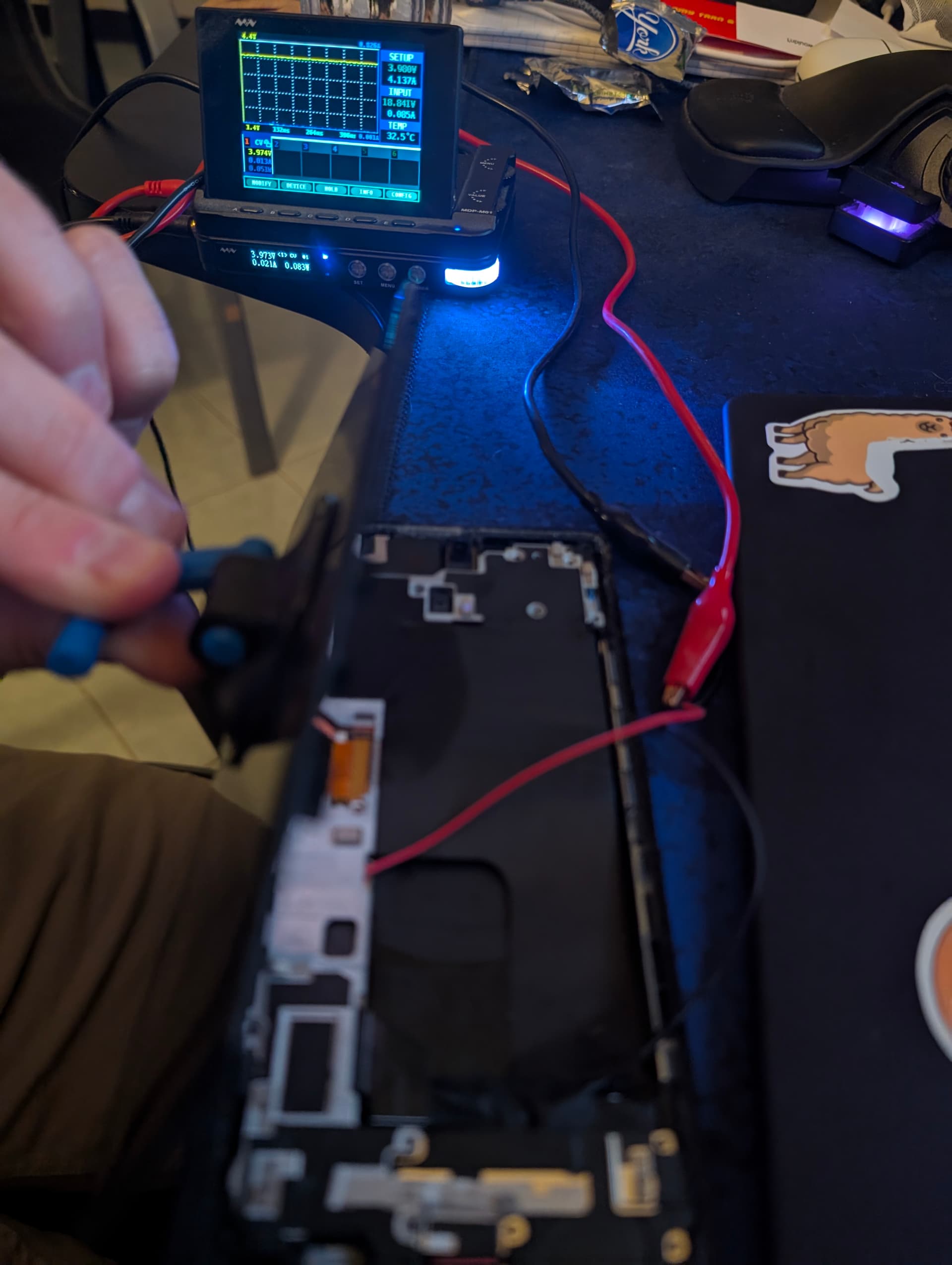

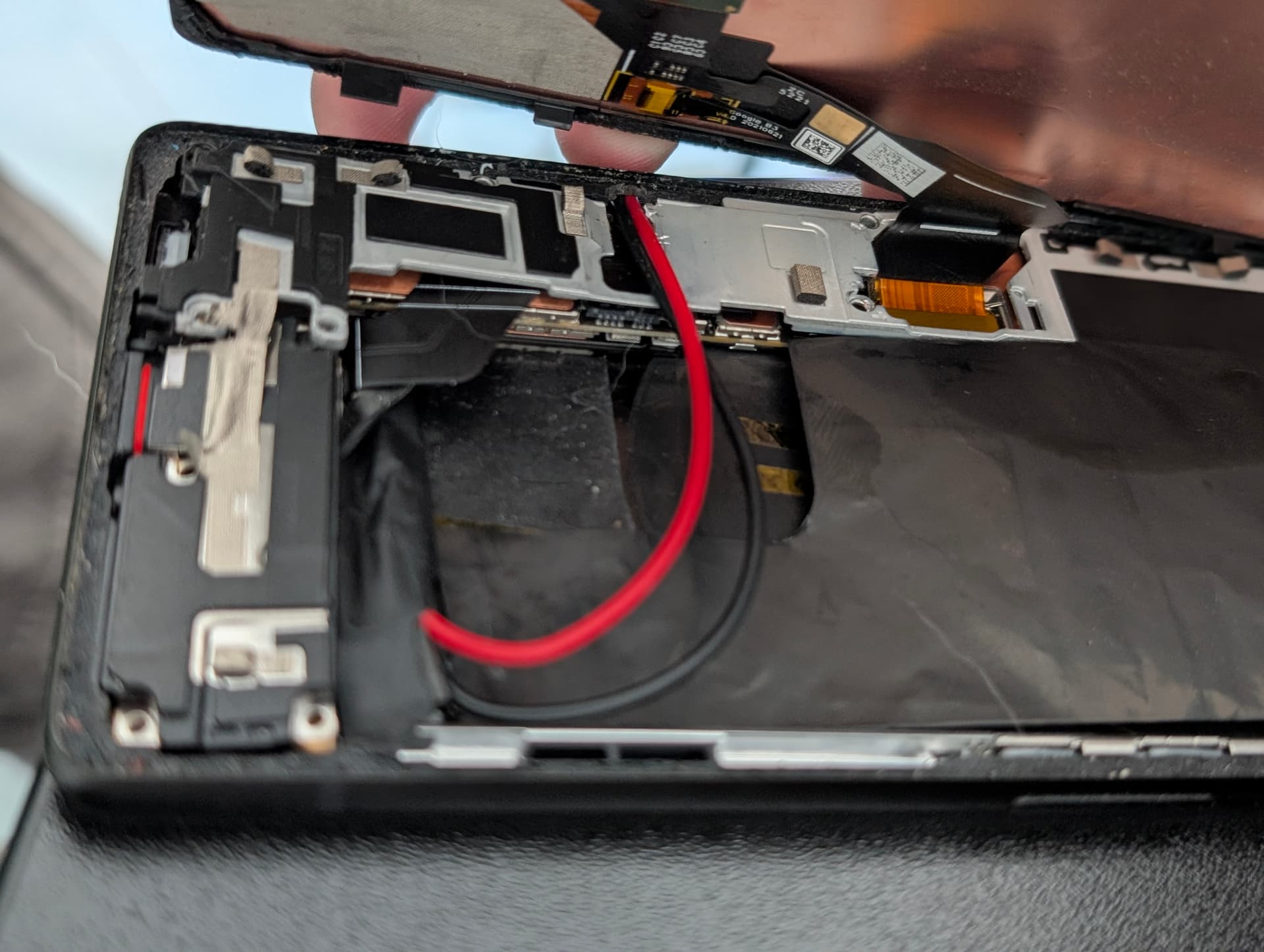

Pixel 6a has a bad battery so I removed it, removed the battery protection board from the batter and wired it up to my adjustable power supply and it turned on to my surprise. Still need to find a permanent solution for this.

Nothing crazy needed to disassemble the phone just some plastic shims and an ifixit guide. I do have a bit of soldering experience nothing advanced though.

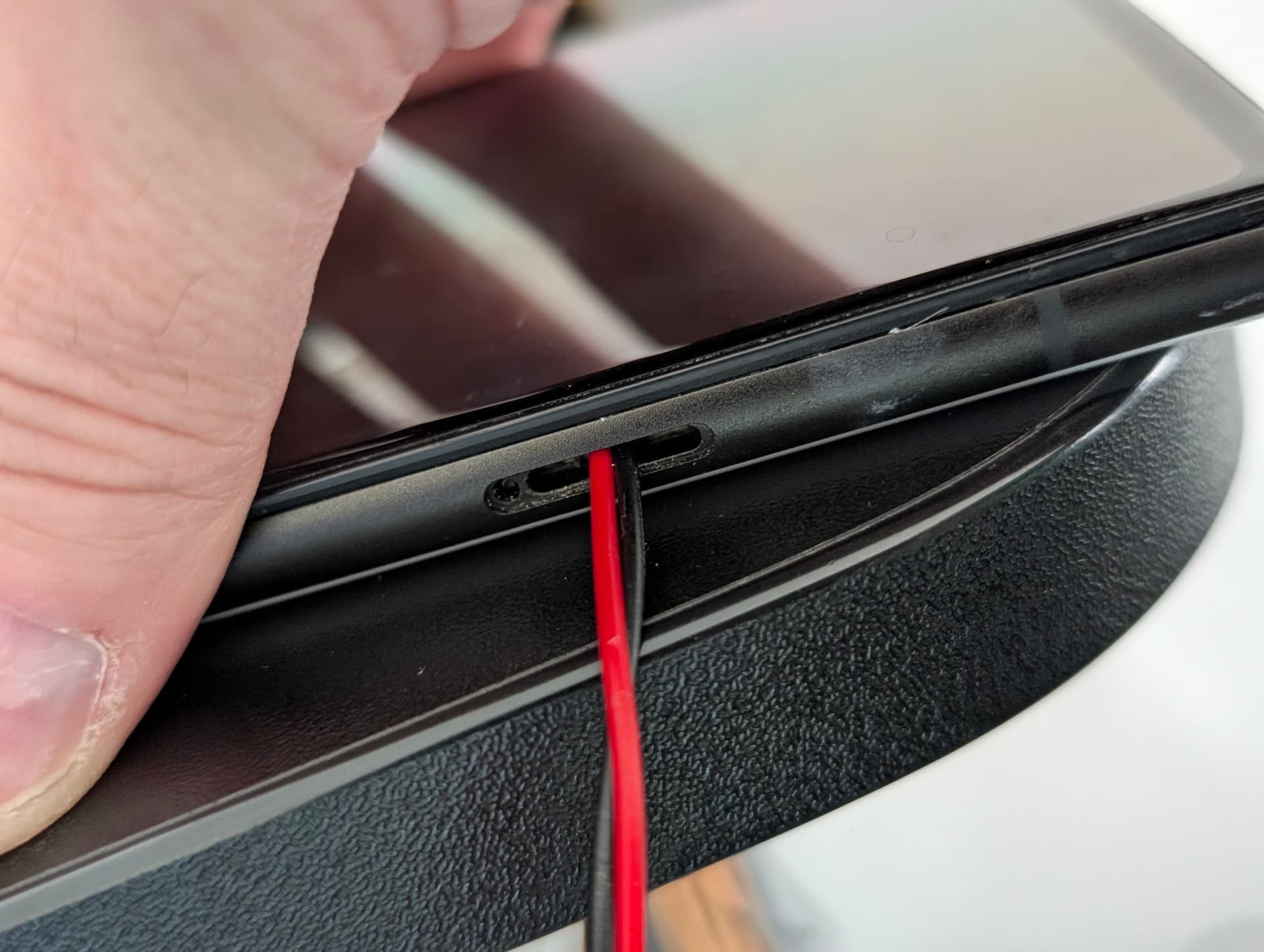

Here I am demonstrating that you can power it via the charging port no issue or via the BMS wires coming out of the sim card slot.

The mod is nearly complete and the BMS board that was part of the battery does not lock out when powered down at least only for a minute. So just need to screw seal it up! It’s exciting.
Edit: BMS board stays functional under long term power removal.

when “charging” the phone heats up a lot, I need to see if I shorted out the SIM card slot as I smashed it a bit to get the wires out through there, this is not an issue when powered from the battery wires.

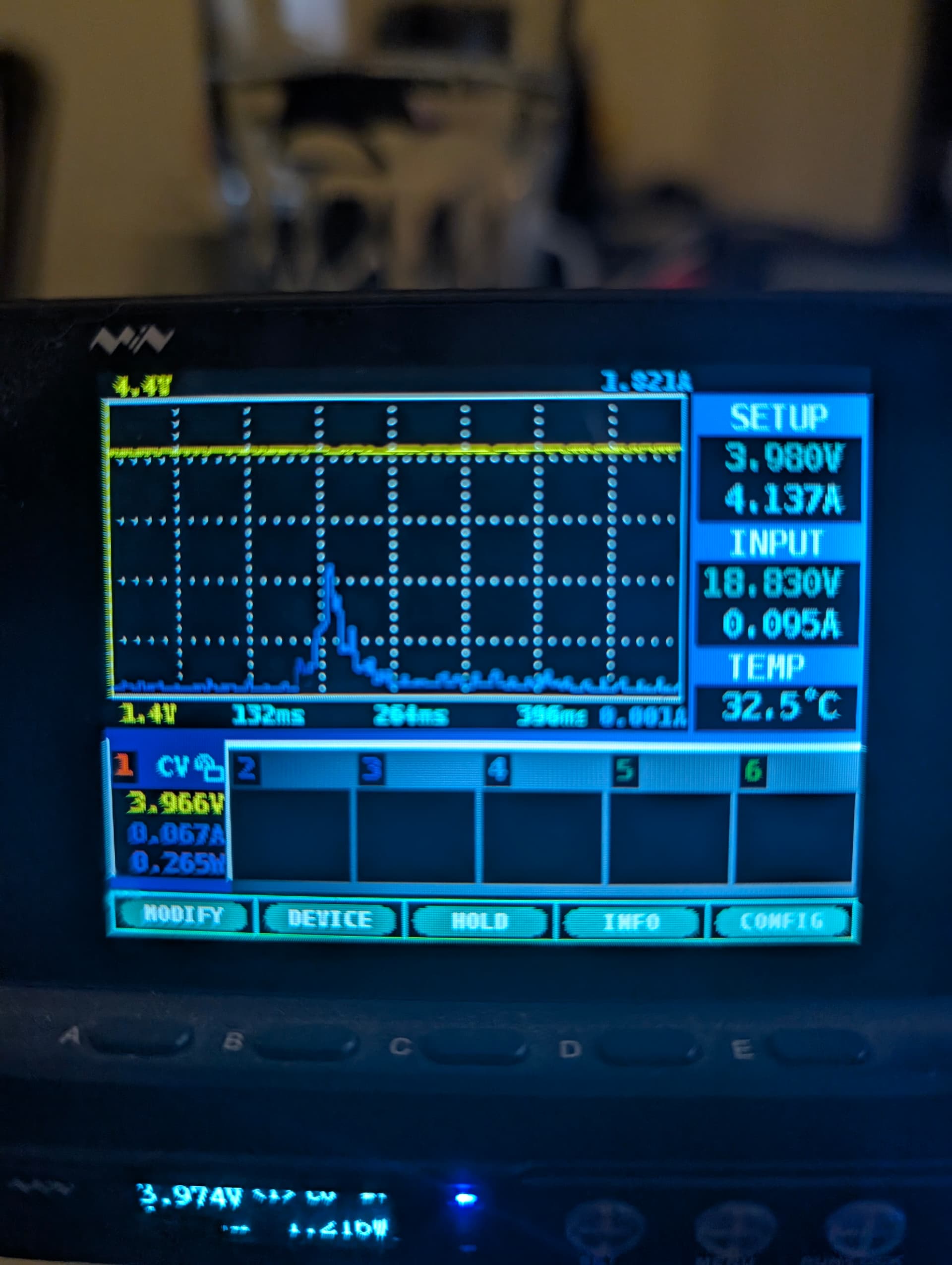

Cool! What oscilloscope is that?
That is a Miniware MDP model power supply. not sure of the exact model number.
I wish I had an oscilloscope, it supplies power while giving readings over time of the voltage and current.
as seen in the video from top right going clockwise
SETUP: output power setting
INPUT: the power being supplied to the unit.
1 cv: this one is the output power as well as the power being read across the leads, this is normally in constant voltage mode it will not really do constant current unless the load allows it.
Edit: the difference between this and an oscilloscope being the resolution this would be an absolute trash oscilloscope. It’s sample rate is very low and not good for actually checking anything more than voltage.
I removed the battery wire from the sim port and put the empty sim drawer back in and the heating up reduced dramatically. So yeah don’t use that unless you put a good insulator in there.
