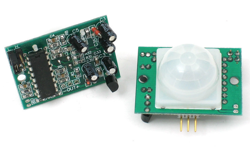

I have a couple PIR sensors , but I wasn’t able to get any of them to only detect “motion” when the person walked close to the sensor. The sensors I tried would always get triggered when people moved anywhere in the room.
PIR sensors are basically a bunch of Fresnel lenses and they detect motion when infrared light “moves” across the detector inside. You can try positioning it above (or even in front of) your target area and blocking portions of the lens so it can’t “see” outside that specific area. Play with positioning and lens blocking.

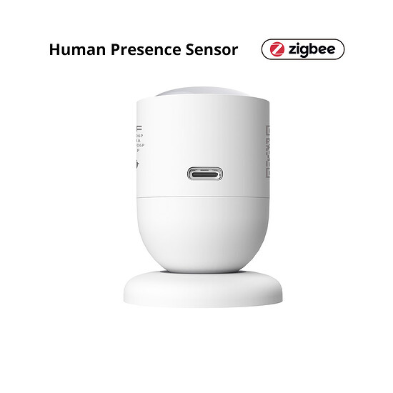

Another option would be mmWave presence detection sensors, but I never played with those.
PIR sensors have no way to differenciate between distance, they’re only motion sensors. You’ll need to use a proximity sensor instead or a camera with some basic recognition built in (even at 10fps you’ll be fine for this use case). One more alternative is using a mmWave sensor, which is a presence device and will give you the best results.
