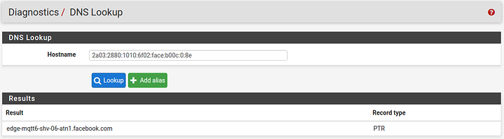

It was then that I noticed another curious connection was blocked by the firewall. This time the connection was to: [2a03:2880:1010:6f02:face:b00c:0:8e]:443 notice the face:booc in the IPv6 address.
DNS Lookup also lists the domain as going to edge-mqtt6-shv-06-atn1.facebook.com:
