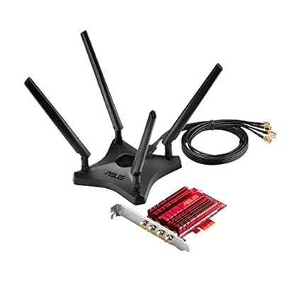

Additionally, I'd also like to have WiFi and I'd prefer to pick a PCIe card, since I'm already using my old PC (ATX) and don't want to waste more space than I already do. I was thinking about grabbing the ASUS card below, but I'm open to suggestions

PfSense is very picky about wireless adapters because BSD doesn't have support for a ton of wireless adapters natively. I'm rather sure that asus pcie adapter will not work as I can't find any confirmed compatibility on the BSD supported hardware lists. I would suggest going with a dedicated Access point instead of a pcie add-in card. Something like a Ubiquiti AC Lite, LR, or Pro. If the Pro's 3x3 setup isn't good enough for you, you could look at the AC-HD, which does feature full MU-MIMO support, but at a hefty price.
According to this question it does work with pfSense.

According to Amazon comment that it might work, and through some further digging there is an old driver might work with any Broadcom based chip starting in BCM43** (this asus is using a BCM4366). The driver is named BWN(4). But, from further digging on the BSD site page for that driver, it doesn't explicitly support the BCM4366, although it does support some older models. Querying the Official FreeBSD Supported Hardware List for the BCM4366 doesn't return it anywhere, so my only guess at why it would work would be that BWN(4) driver, but even that's a guess.
