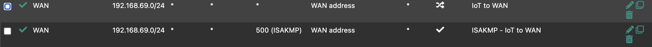

Nat (the .69 network is my IoT network…)
