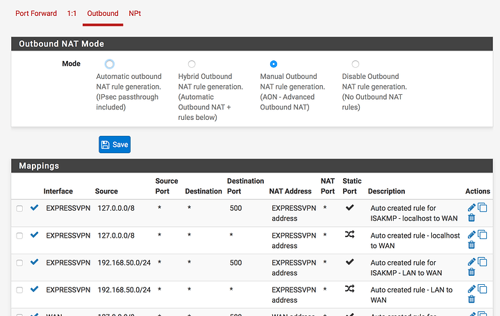

Did you configure the outbound NAT?

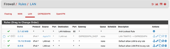

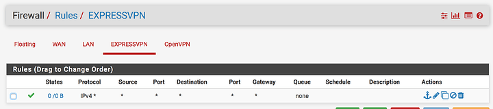

If that doesn’t help can you post your firewall rules.
![45 pm|720x210]
No luck, I did a fresh install also.
I’d get rid of that allow rule on the VPN interface, you want to treat it like WAN and block all inbound traffic. But that’s not the problem.

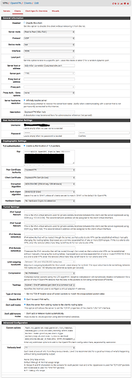

The VPN is definitely connected and working? Those rules and everything look okay. Can you post the VPN settings?

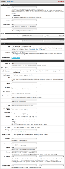

VPN rule added to try and fix the issue

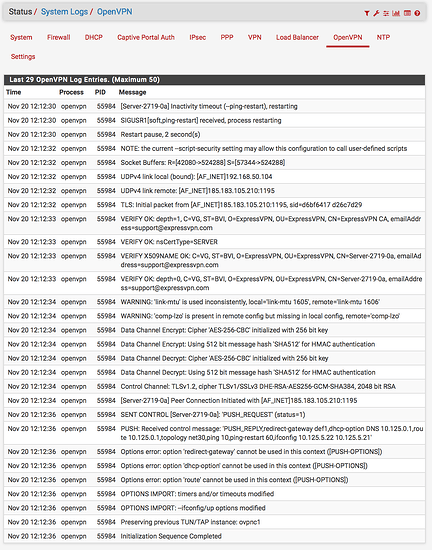

What are you seeing in the VPN logs? Some of those options may be making it fail. It might be worth turning the logging down a bit to make it easier to spot any errors.
If the problem is in fact your traffic is successfully leaving through the VPN but not coming back, that sounds a lot like a reverse path filter (link to post) problem I ran into. Reverse path filter is the name of the function in linux, I am not sure what bsd calls its analog. But with reverse path filter turned on, when my traffic returned over the vpn tunnel interface, the traffic would be silently dropped since the filter expected traffic from a non-local address to come in over the wan interface. Once I disabled reverse path filtering, return traffic over the vpn interface made it all the way back to the local hosts.
So looks like the VPN isn’t connecting and it looks like some of those options are incompatible with the server config.
To start with I’d set compression to adaptive or on (off will work too but you might as well have it on). Then get rid of the tun-mtu option and the push options.
These are the options I have set on mine:
remote-cert-tls server; persist-key; persist-tun; reneg-sec 0; mute-replay-warnings
Plus fast io which is a check box on 2.4. If you set options which the pfsense client doesn’t support or the server doesn’t support that will stop it from connecting.
But judging from the logs it looks like it’s the inconsistent MTU setting which is causing the problem.
Thanks, removing the fast-io; did the trick.
