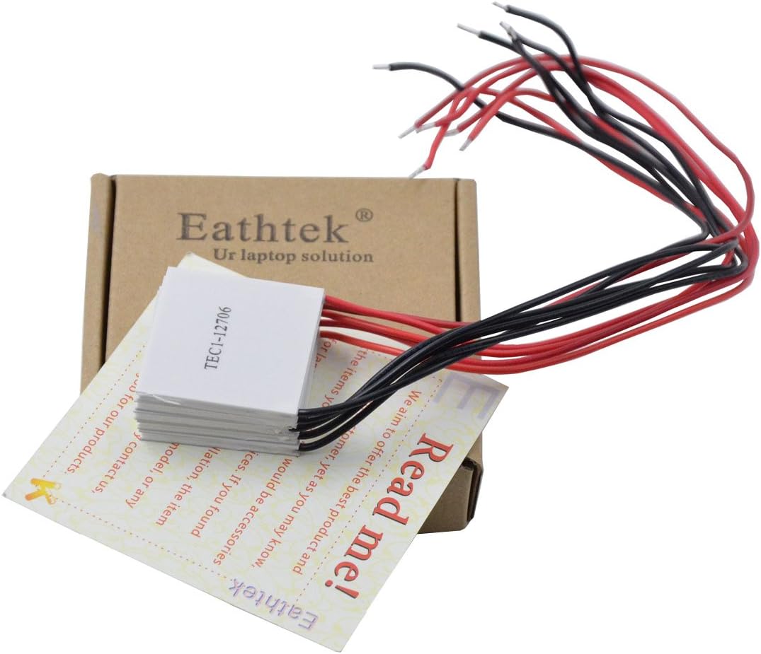

Hey guys I think I want to start a project with Peltier modules. They will be able to heat or cool a thermos.
Here is the parts list
-Vktech TEC1-12706 Thermoelectric Cooler Heat Sink 12V 5.8A 5Pcs

Nice project & good luck! But where will you put the peltier element so that it can cool the inside?
Some way I would like to put it inside the thermos insulation.
Ok, but you will lose the vacuum - so isolation will suffer (might not matter with a thermoelectric element to cool it, though).
I believe that @GigaBusterEXE has been messing with peltiers recently. Perhaps you guys can compare notes.
I got that 5pack of 12706's and they're good
though I don't think you can reverse which side is hot/cold without physically flipping it over, and I believe the side with the numbers is the cold side
and you will need hotplate to spread the heat and act as a buffer, remember its not a good idea to get the lower amperage ones above 80c
I couldn't make a hotplate for a candle running at 3.3V/6A/19.8W because it wouldn't transfer the heat fast enough, I'd need a lower amperage/voltage
a thermos would have a different composition than a thick glass and wax candle though so Idk
