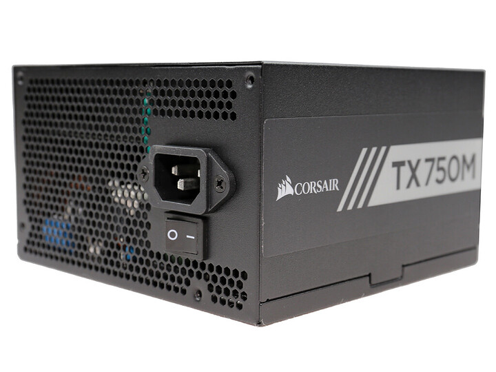

My old b450 and 5700xt setup runs of a corsair tx 750m psu.

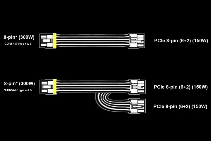

decent PSU manufacturers use a thicker wire when they do two 8pin connectors on the same cable. So it can carry the current of both 8pin connectors safely. Cheaper PSUs may not do this, and may burn down because you are overloading the wires.
Since you say you have a corsair tx 750m, this is the page where Corsair says their cables with two connector aka pigtails are designed to carry 300w over the main wire and then split it to the two pcie power connectors, so the cable is still in spec for the power it must carry and will not burn down.
A well-constructed 8-pin cable, such as our PSU cables with pigtail connectors, should be well capable of providing more than 300W of power.

they say pcie wires on that PSU are awg 18, which means 16 amps per cable, so since there are 4x 12v cables that translates to 64 amps, which translates to 768 watts at 12v.
So you should be fine with using the psu you have and connect all the 3 pcie power connectors to the new card (2 will come from a cable and 1 from the other)
