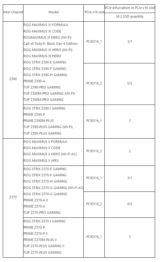

I dont think biforcation is something supported on that old of product. I could be wrong, but thinking about it some more i feel like biforcation was only like a 2xxx/3xxx ryzen stuff first then added to other stuff later.
https://www.asus.com/us/support/FAQ/1037507
Probably any Z590, Z490, Z390 and Z370 board
That URL has a ton of good data for ASUS boards
I know Wendell has reviewed quite a few boards, over the years. Could be a good start point
@mutation666 thanks for the chart and link. I read a few manuals from the Asus z370/90 boards and saw only a brief mention of bifurcation for nvme ssds, as your chart showed. I’ll have to check my board to see if toggling that helps me.
You may be right that I need to be looking toward more modern platforms. Ill have to look at the 10/11th gen processors and boards to see what is available and their mother oard compatibility.
