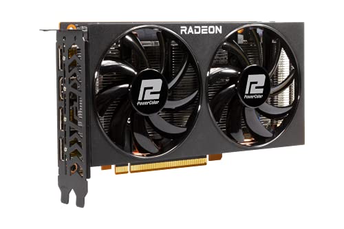

@HavixPickle The best price/performance card for getting great 1080p framerate and will work on your power supply would IMO be the Radeon 7600 XT.
