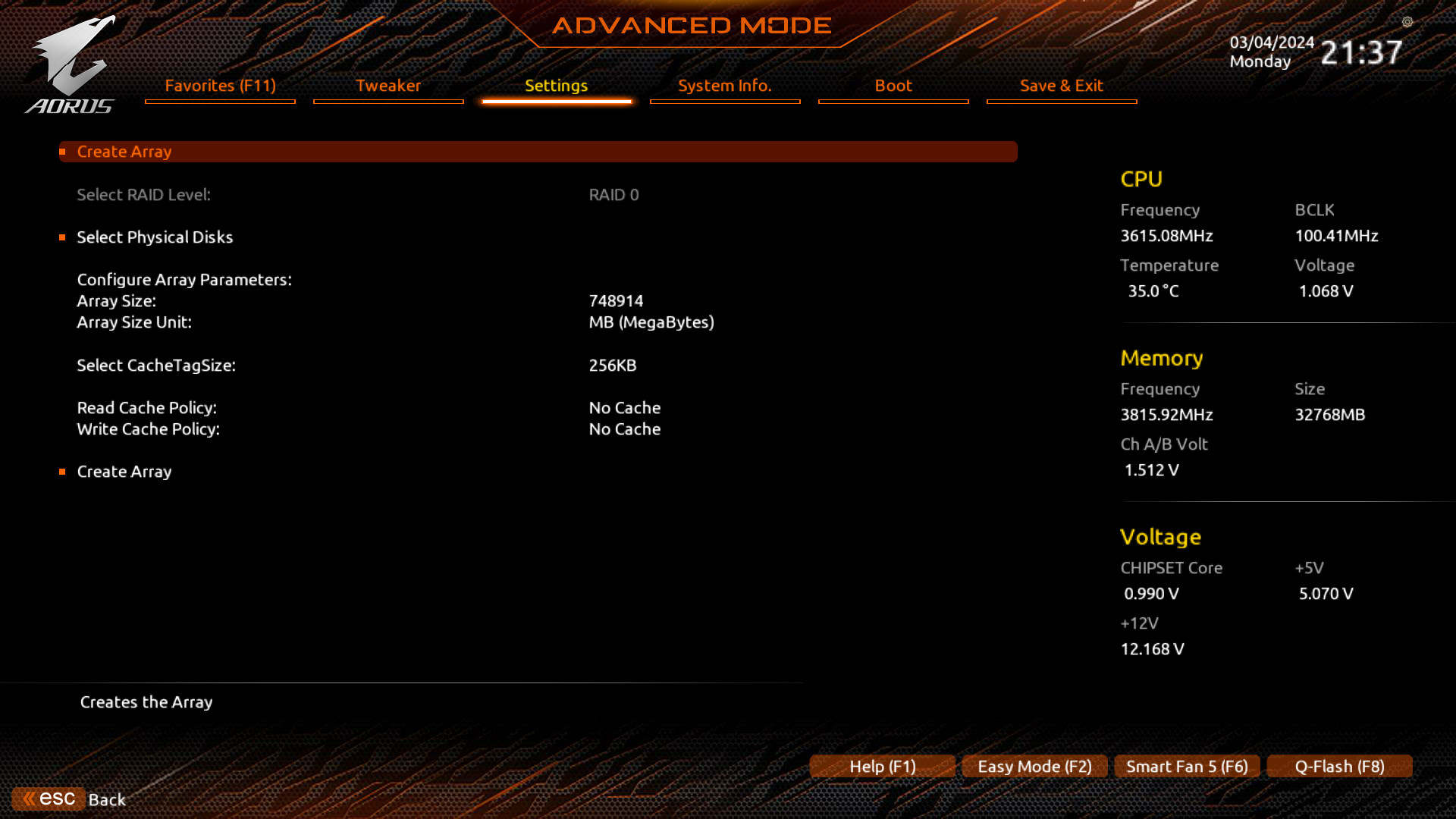

Here are my RAID 0 Array settings in the Bios:

Anyway here are the results, first with 9.3.0.296, then with 9.3.2.158 after seeing how bad the performance was.
DiskMark64_04.03.2024_22-23-28DiskMark64_04.03.2024_23-31-11
Tried Win10 SW Raid after uninstalling that mess, here is the result:
DiskMark64_05.03.2024_13-36-48DiskMark64_05.03.2024_15-10-07
So yeah, AMD HW Raid 0 bad, wish Win 10 SW Raid 0 were bootable…
