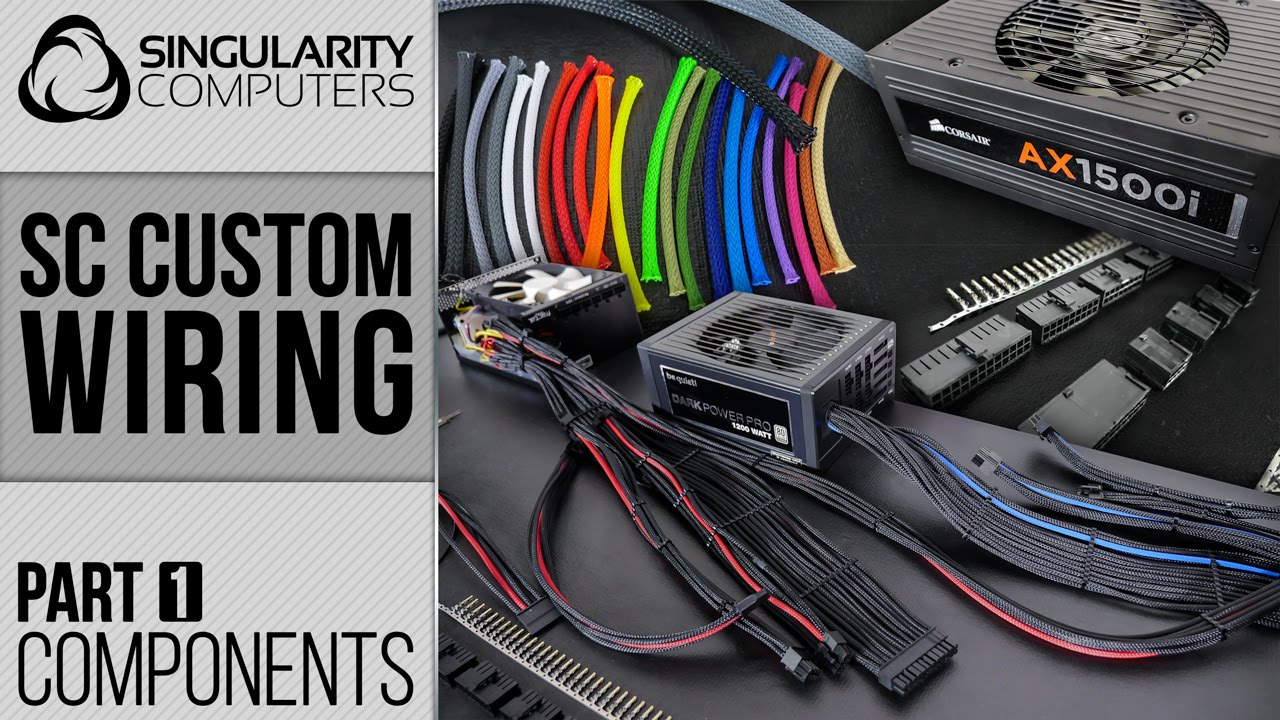

Singularity Computers guide on Custom Cables:
