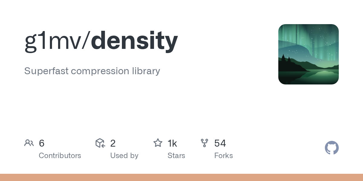

I’m tempted to go with zstd, just out of curiosity for a new fancy algorithm. Maybe level 3, which happens to be borg’s default setting for zstd. The Density compression algorithm mentioned above is also interesting, but I definitely don’t want to complicate my life with borg. The closer to defaults, the better.
