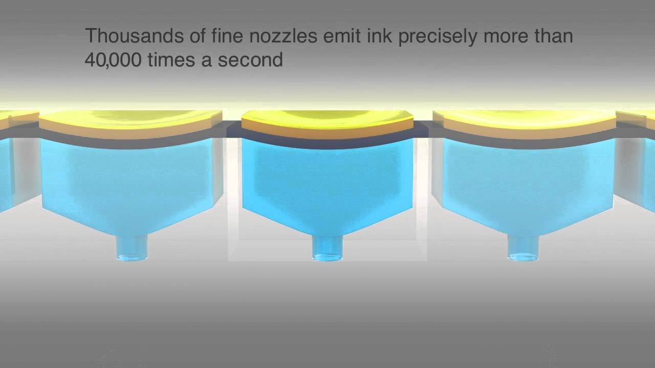

Don’t think this is practical on ink jets, if you are out of color and still try to print black only, that would pump air into the rest of the print head and that’s not good. You may need a radical head redesign since only the big players make their own. You may be able to get them from Seiko, they do supply a lot of third party manufacturers, but mostly in large format scene.
Yep, as simple as using a syringe and needle and possibly a vacuum clip to pull the ink trough the print nozzles if they are part of the cartridge. But this type of ink cartridge is on it’s way out, these are from another era where manufacturer would sell printer at a loss and make up the difference in super expensive ink cartridges.

Not really, print head will still have ink, just not squirt it out. Air dries ink out, and the print head will move to cleaning position and spill some color ink into maintenance tanks even when you only print black. After the print is complete it will wipe the nozzles and seal the head to prevent drying.
There is no black only printing on ink jet without expanding some small amount of color ink too. Is this done on purpose as anti-consumer thing - I can’t say, but having separate ink pumps and nozzle control is more expensive.
There is progress however, at work we have a few modern Epson large format printers, and those can run color cleaning cycles in sets of two while older ones do full head clean or nothing.

Wow, printheads were pretty advanced, even 7 years ago…
I’mma be real impressed with the machining skills of anyone reproducing from scratch…
