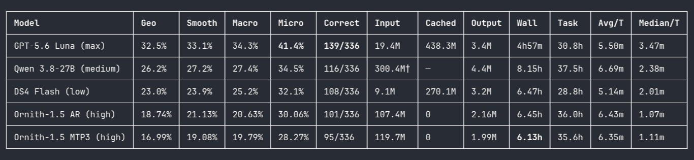

I’ve been running my own evals (this is a mix of various agentic/coding benchmarks including BigCodeBench, Terminal Bench, and DeepSWE / SWE-bench subsets running in Pi as the harness) and surprisingly, Qwen 3.8 27B outscores DS4 Flash. It probably runs faster as well. Also Ornith 1.5 35B-A3B score pretty decently and is also quite fast (and is much more token efficient!):
