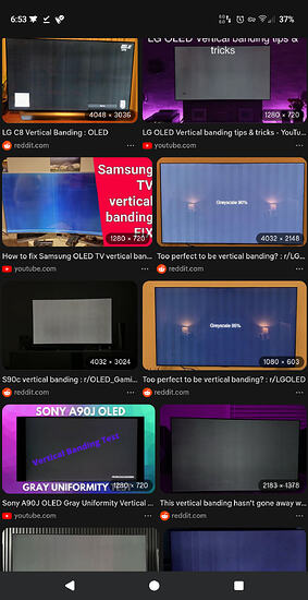

Interesting. I’ve never owned a large OLED display, but a quick search of “oled vertical banding” and there are no shortage of results. I will certainty be checking for this when I buy an OLED.
