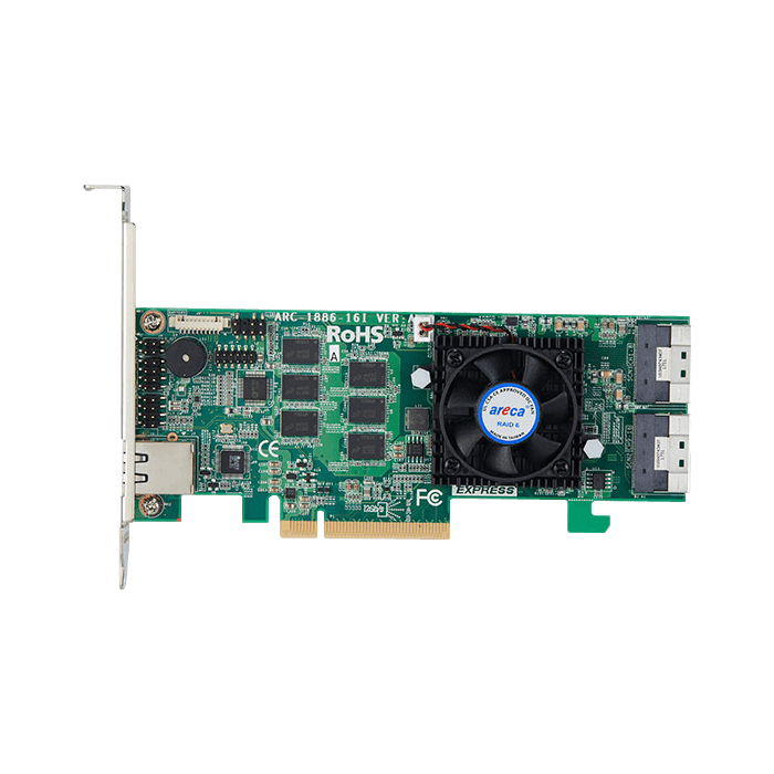

The centerpiece of this build is going to be the raid card.
I decided on Areca due to the amount of control it gives over very low level functions of storage that I haven’t seen anywhere else, as well as the out of band management it has for peace of mind; the last thing I want to encounter one morning is a no boot situation and having to worry about the integrity of my storage.
ARC-1886-16i:

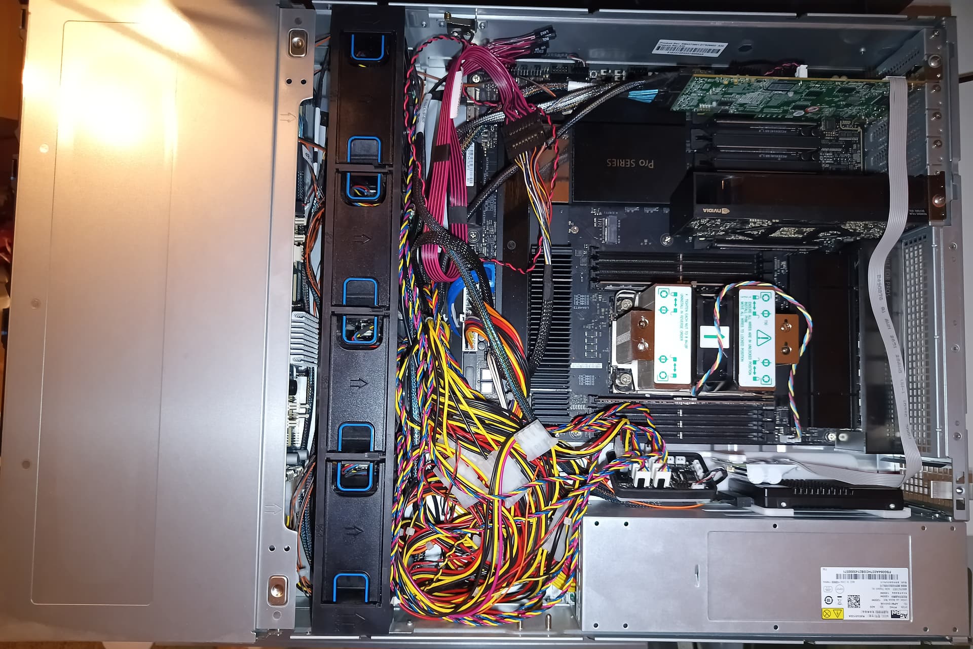

I put the system together to get an idea of what I was dealing with:
  • The first problem is the CRPS power supply isn’t modular and is making a rat’s nest of cables and blocking airflow.
    • I’ve ordered a FSP modular CRPS PSU to remedy this; I’m likely going to have to make my own cables for it.

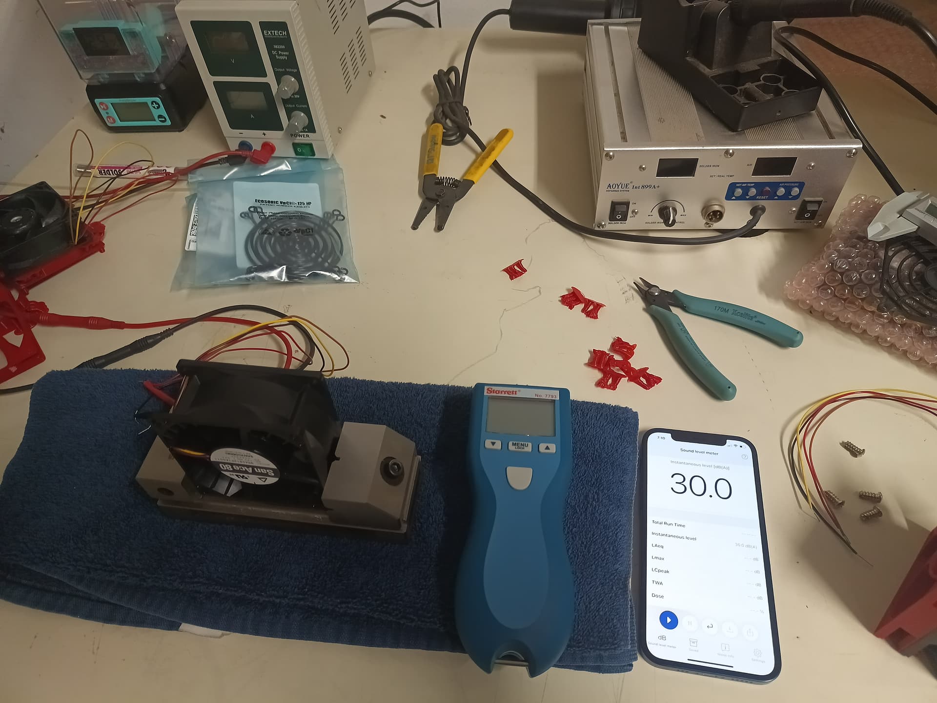

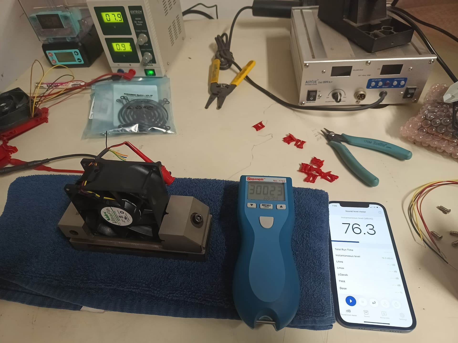

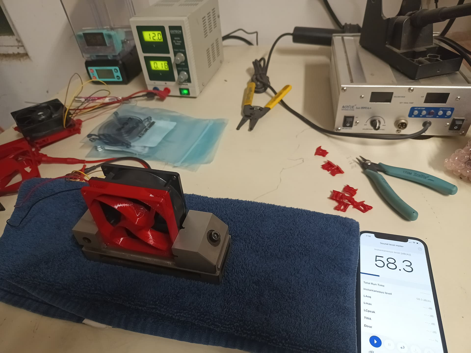

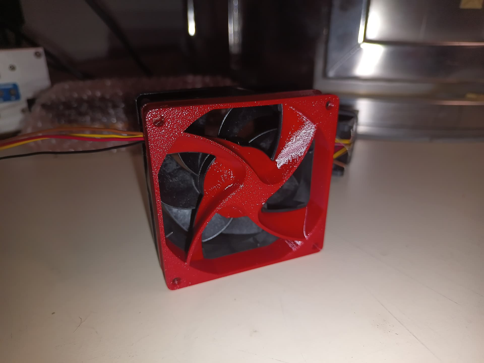

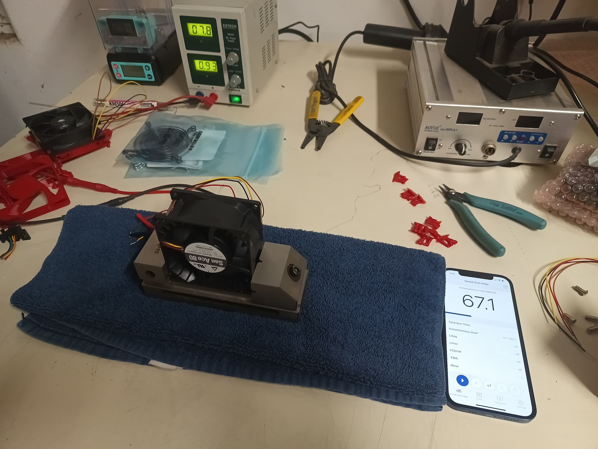

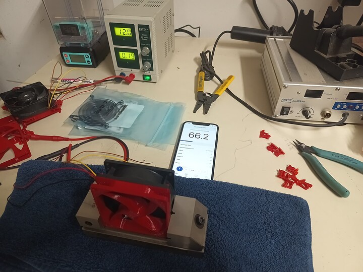

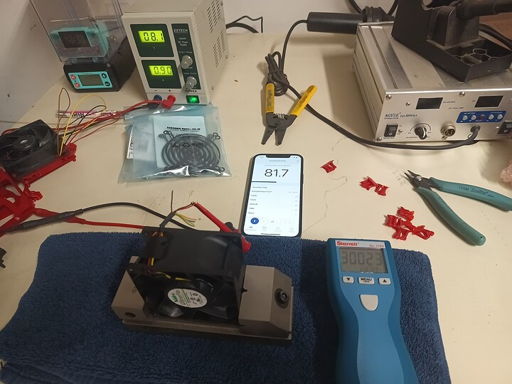

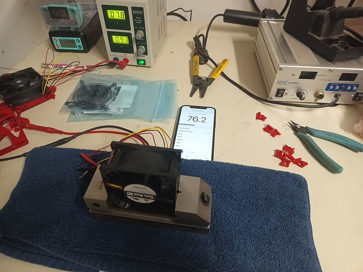

  • Another show stopper is the noise this system produces, I want it to be quiet enough for an office environment but the 80x38mm fans are screamers. Even after installation of an octo to prevent the 100% fan ramps during boot and control the fans better during steady state, I can’t get them quiet enough while cooling the backplane expander chips to comfortable levels.
    • I’ve ordered an array of 9RA fans to swap in to get the noise down. In my experience they are usually ~10dB quieter than “industry standard” fans at the same performance level.
      I’ve also ordered some 40mm fans to attach directly to the expander heatsinks (there are 32x32mm mounting provisions on them to do this). Finding 40mms without obnoxiously large motor hubs that restrict CFM is more difficult that I would have imaged.

I got around to “benchmarking” the fans I bought, but the more I think about the method I used the less I like it.
At any rate, here’s a dump of pictures of original 38mm thick fan, the 9RA 38mm thick fan and then the 9RA 25mm thick fan running at either a similar power level for the first two, or the max power level for the 25mm thick fan, with two different mic placements:
noise floor
Nidec UltraFlo
38mm thick 9RA
25mm thick 9RA
I didn’t quite get the 10dBA reduction in noise I was looking for, only 5.5dBa reduction from the front mic location measurement and 9.2 dBA from the side mic location on the 38mm thick fans. The 9RA fan does have a more pleasant quality to the noise it produces, it sounds less rattly than the Nidec.
The 25mm thick fan isn’t really comparable in performance to the other two, but it does “throw” the air pretty far with the 25mm>38mm thickness adapter to the point it feels as strong as the 38mm thick fans if you have your hand far enough away.
I’ll be using the 25mm thick fans in the upper chamber of the case since it only needs to pull air through a single backplane of restriction. The bottom chamber of the case is much more restrictive and will need the 38mm fans.
