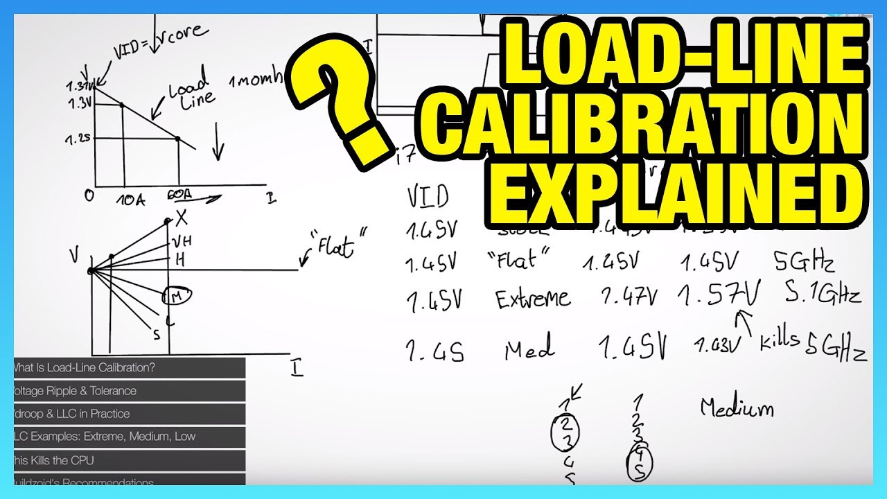

You shouldnt need to go all the way to 1.41 to hit 5.1ghz. Try 1.35 @ 5ghz and see if that runs. if you’re going to go for this you should turn off auto voltage as well as any kind of turbo. Also look into vdroop and LLC because those are going to be crucial to understand. Gamers nexus has a good video on LLC and what you should do with it.

This is long but informative
