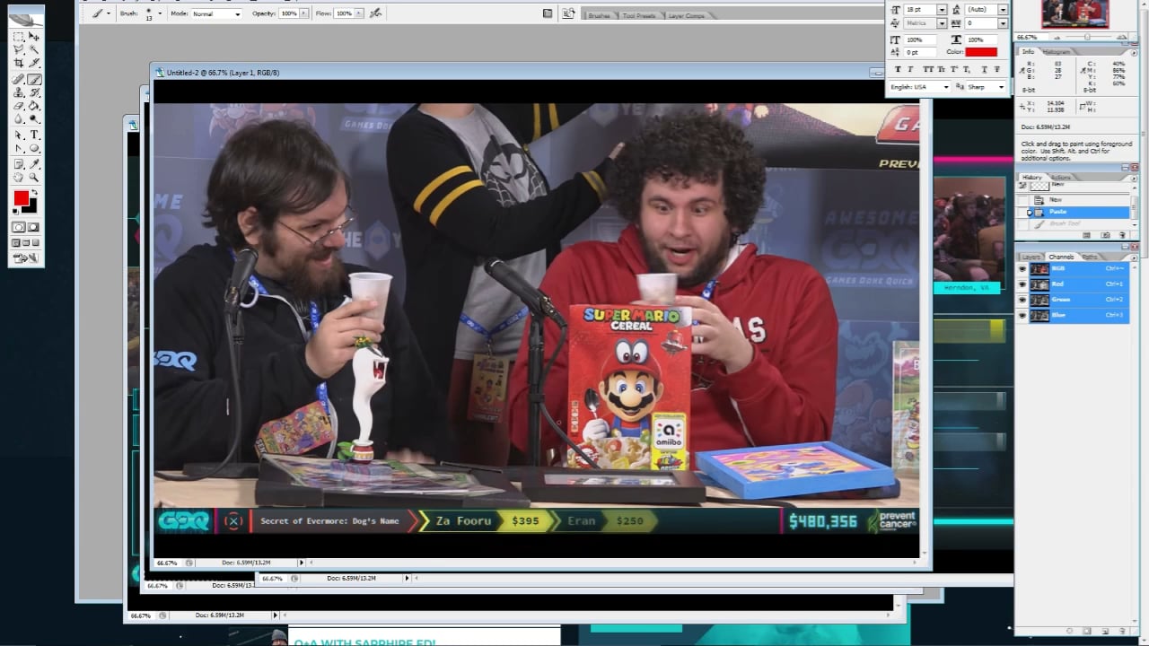

Hey, AGDQ boldly asked of Jim from the OBS team and the OBS team delivered. They got custom builds to do specific layouts which I’m not sure if they merged it.
It is kind of incredible they ran a PC with OBS for 7 days non stop with Avermedia and Elgato cards.

They just said at the end of the stream “Thanks to Jim from the OBS team for giving us special builds at the last minute.”
Edit: Here’s some original research based on what I saw in the beginning of the Mass Effect VOD. A capture card lost sync so a camera was blank, in troubleshooting it, the MIXER PC rebooted and the stream encoding PC kept going…
That’s how they did it. The PC doing all the graphics and mixing all the capture cards was only connected to the net to poll donation incentives, total donation count, and read tweets. It was not streaming. That PC then had the OBS canvas projected to a secondary monitor which was then hooked up to another Elgato capture card to stream out the stream… Unfortunately, I think that’s why the stream was 1600x900, because it was using the OBS default resolution of what was likely a dedicated encoding laptop, with a screen resolution of 1600x900. Also, Elgato and Avermedia capture cards meant they could only use Windows, not Linux (If it was purely Blackmagic capture cards, they could use Linux)
They may have had a hardware mixer for the interview set though, and that was on it’s own dedicated capture card input.
I personally would have used OBS for overlays (Downstream keyers) by a feature I would like so that OBS can project using 2 fullscreen projectors both the fill (graphics with color) and the key (Alpha channel represented as white brightness values) and feed that into a hardware mixer via 2 secondary monitors.
