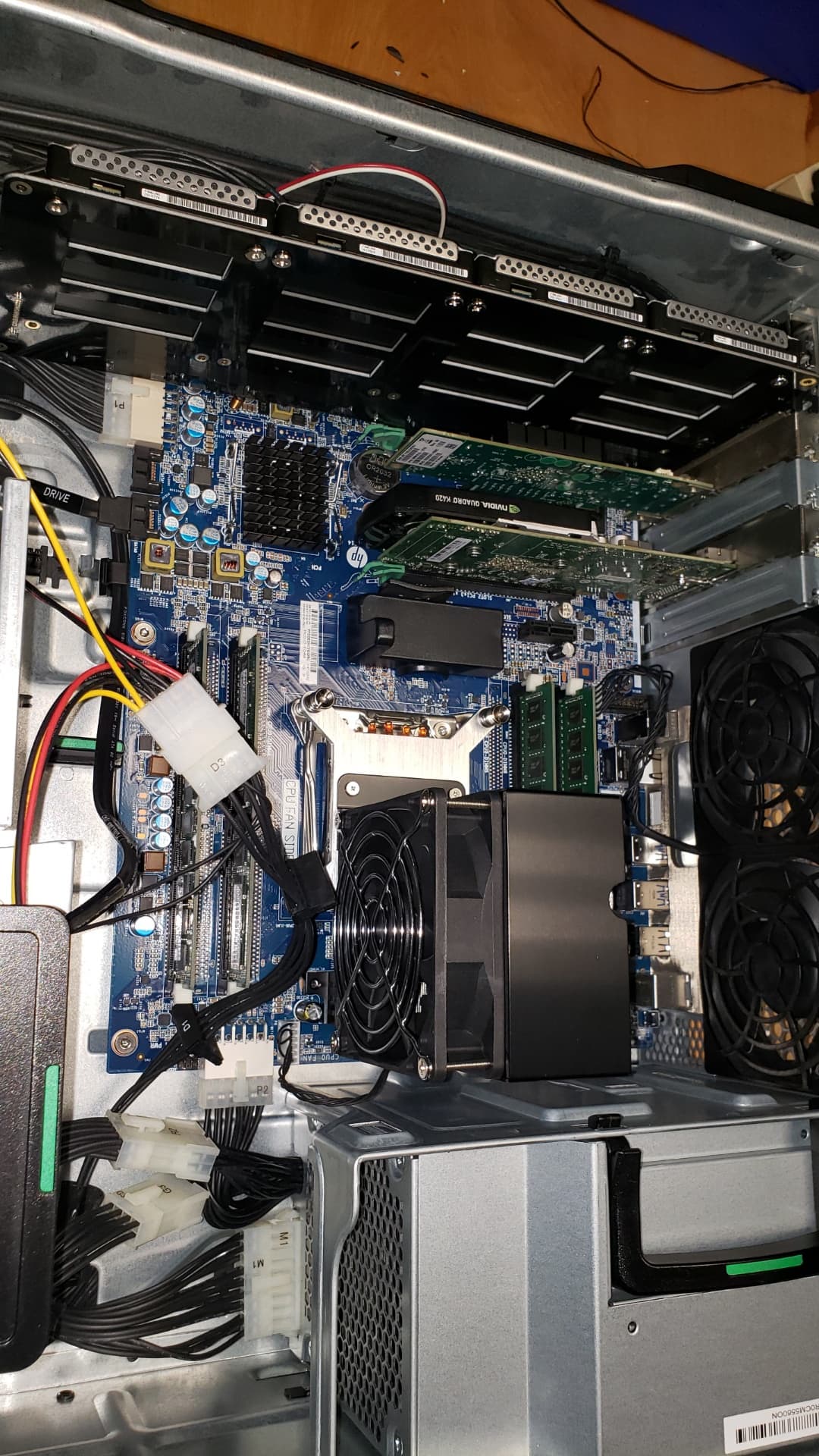

Depending on how much storage you need, I am building some machines for a Proxmox Ceph cluster for our developer. We are using some HP Z640 workstations. These machines support x16 bifurcation to x4x4x4x4 so I put in a four space U.2 adapter. ConnectX5 100 GB adapter and Quadro K620 graphics. On these workstations the X4 and X8 slots are open ended so you can put the graphics card in a x8 slot. I have this running on Windows 2022 for some testing and I was able to full saturate a 10GBe connection. I can’t test the 100Gbe until I get the second one built. Which should by the end of this week.

Thought I would give an update. We built (5) five of the HP Z640 workstation servers. Each machine has (4) 1.6 TB Kioxia M.2 drives and (2) SATA SSD drives. SATA drives are mirrored for the OS, Proxmox with CEPH. Because we ended up running a Microtik 4 port 100GB switch we have 25GB breakout cables connecting the cluster for the CEPH traffic. With all the U.2 drives the cluster is running with zero latency.
