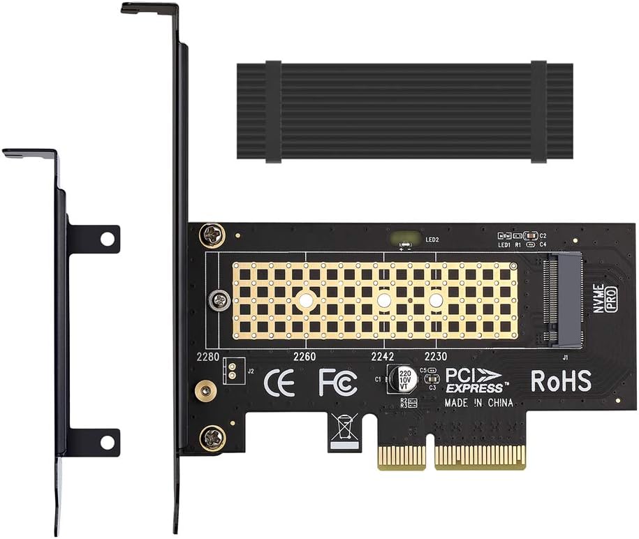

- The board’s M.2 slot vs PCIe x4 expansion card
