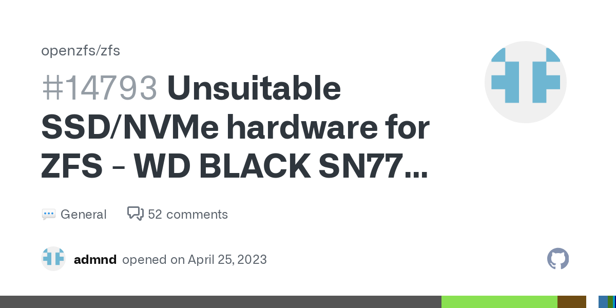

You may want to read this before getting an SN770 (or at least before formatting it to 4 KiB sector size):
Having read through it, that’s more like you want to read this before using zfs with NVMes. Not much left if you exclude all HMBs as suggested in the issue and then start crossing off the DRAMed drives people mention problems with.
Personally, seems like it’d be easier just to exclude zfs.
I won’t pretent to know the actual issue here, but it seems to me to be more related to some SN770 bug with 4 KiB sectors than to ZFS. A couple of quotes from GitHub:
I guess using 512 B sectors is a work-around, but annoying not to be able to use the most performant format. (Unless the performance is the same between 512 B and 4 KiB on the SN770; I have no idea really.)
Edit: To be clear, there are likely multiple issues represented in that thread, both ZFS ones and a plethora of different NVMe controller issues. One of them (and the original topic) seems to be a SN770 bug with 4 KiB sectors.
