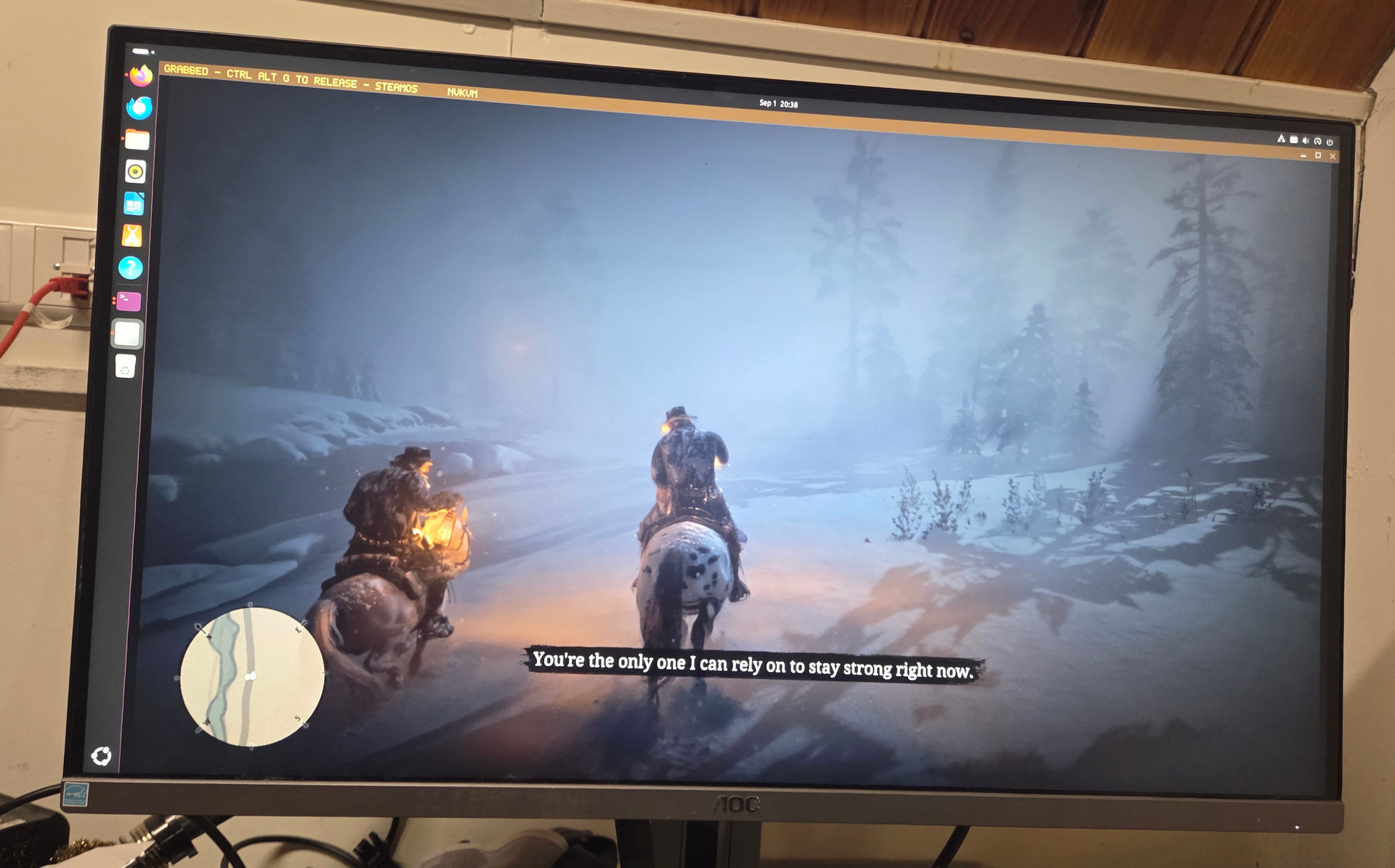

Running Red Dead Redemption 2 in a KVM guest:
