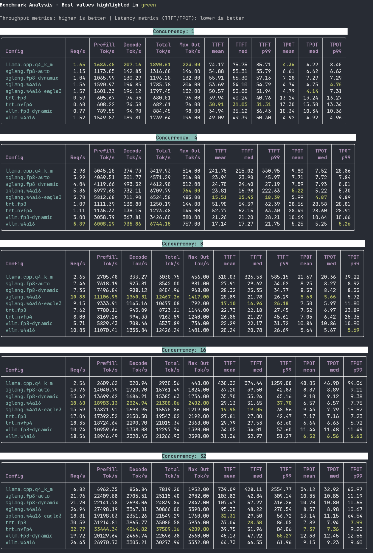

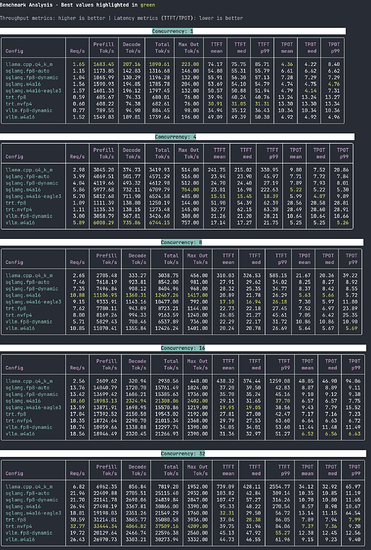

I got a little curious about whether NVFP4 on Blackwell actually matters. I don’t have a Spark, so I just tested on a PRO 6000, and it doesn’t look like it.
For those interested in digging in, results and replication data here: speed-benchmarking/nvfp4 at main · AUGMXNT/speed-benchmarking · GitHub
(NVFP4 may be useful for training, but based on my testing, benefits for inference are questionable except maybe at larger/non-interative batch sizes)

The NVFP4 was tested with w/ TensorRT/trt-llm, not vLLM.
As for quant quality, there can be huge differences between quants of the same precision based upon calibration and specific quantization techniques (eg SpinQuant with online Hadamard rotations vs RTN or SmoothQuant). People should eval their models against their own downstream use cases for quality, but the argument that somehow there are huge performance gains people are leaving on the table right now by not using FP4? Not from my testing.
Whether there’s more juice to squeeze in the future, only time will tell (but you’re right, I dgaf about any theoretical advantages if they’re not reflected in actual real world performance).
