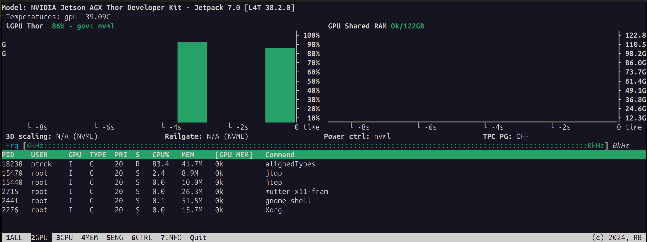

Install jetson-stats
sudo pip3 install --break-system-packages jetson-stats
sudo groupadd jtop
sudo vigr # Add user to jtop group
sudo vigr -s # Add user to jtop group
sudo ln -s /usr/local/jetson_stats/jtop.service /etc/systemd/system/jtop.service
sudo systemctl enable jtop.service
sudo systemctl restart jtop.service
sudo systemctl status jtop.service
Fix jtop JETPACK not installed message
44,45d43
<     # -------- THOR -------
<     "38.2.0": "7.0",
/usr/local/lib/python3.12/dist-packages/jtop/core/jetson_variables.py
OR (Use my fork that has the variables and nvml fixes)
