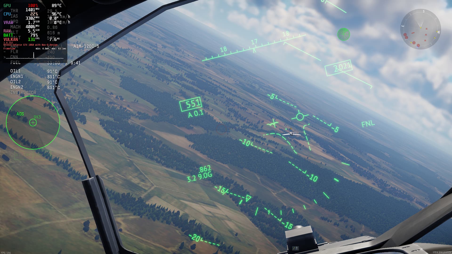

Use nvtop and see if it is utilizing it when gaming. Or install mangohud and activate the overlay in game, it tells you what you are using.

mango hud shows the 1060. also the stutters are visible in the frame time graph as spikes at more or less regular periods.

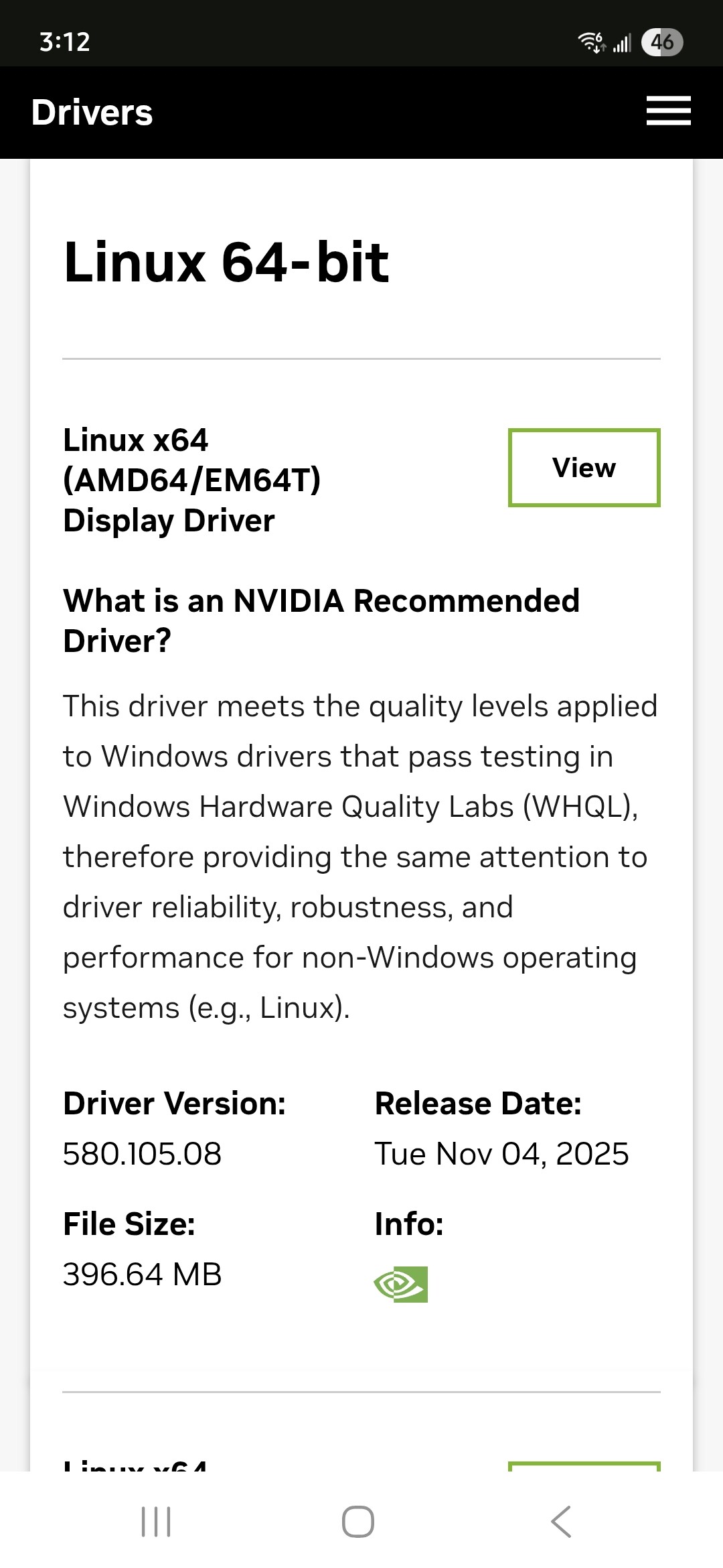

Nvidia does seem to think the 1060 is supported on the latest proprietary drivers. But it seems like maybe you didn’t follow the installation procedure correctly? The monitor is plugged into the gpu and not the motherboard, right?
