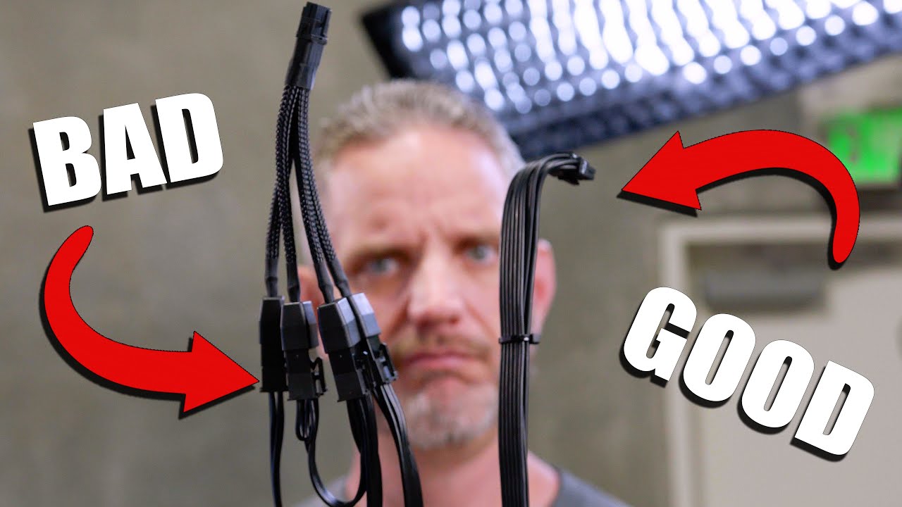

Edit: Also make sure, the cables of the power adapter isn’t bended to tight, 600W is going through a small connector.
Ive seen Jay and Igor describing the same. In their cases it was the saveguard pins not detecting the correct number of connections. Thats why the fan does not even start. Maybe worth checking all connections twice and going more into detail. Did you use 4x cables from the psu to the gpu?
Due to the supposed enormous power consumption of the RTX 4090 I went ahead and also purchased a Seasonic Prime 1.6KW PSU (I made sure that the cables are compatible because I did not want to re-cable everything in my PC.) While I do intend to return this PSU because it is not actually needed, I quickly tested it as well and had the same result.
As a result, I have two 12VHPWR cables at my disposal, one smal dongle that connects with 4x8pin connectors and one larger cable that ends in 2x8pin connectors. I have tested both on either PSU but the fans won’t spin up regardless.

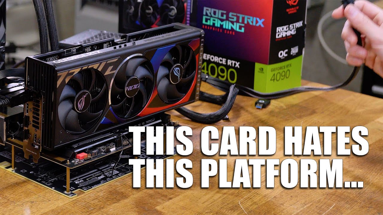

in jayz video his AIB card wouldn’t start on his asrock motherboard while the FE would. Around 6:30 in the video.
This would be a catch 23 for me…how to install VBIOS when the GPU is not working in the first place? It’s a pity he does not plug it in in this video, so I could at least see if RGB lights up and things like that.

Jay has released a second video where he explains everything in more detail:
As you can see, in the video the fans of the Strix spin up and the RGB goes on, while my card does not react in any way, shape or form. Thus, I assume my card is truly broken. (The only thing that still strikes me as odd is that the board’s debug code is still AA, which basically says everything is fine…)
